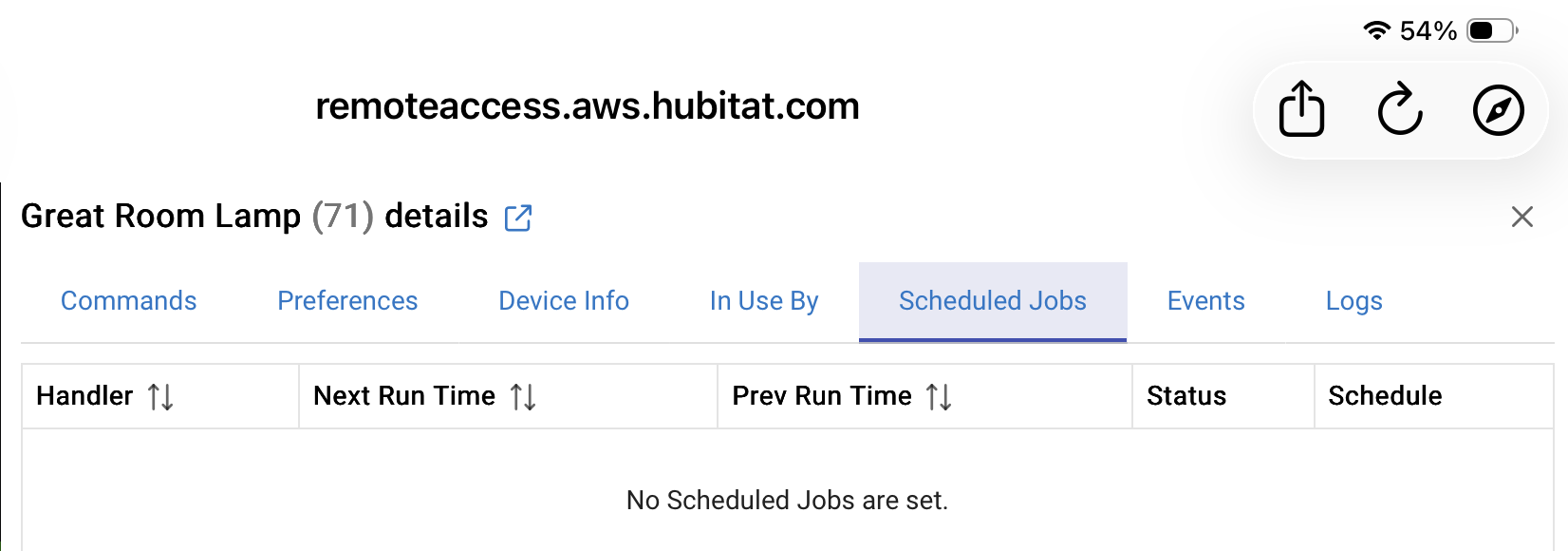

No scheduled jobs in your device page?
Absolutely none. No reason I can think of for me to do any scheduled jobs on these switches.
