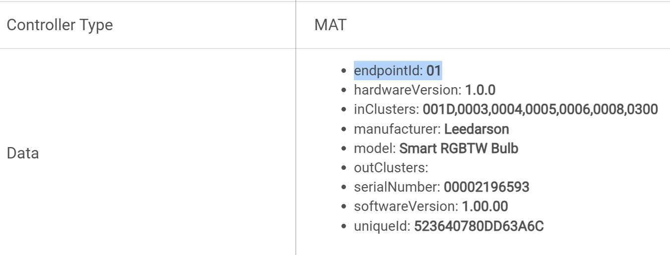

My device data is shown below (again, Linkind) - What are the details you are seeing:
