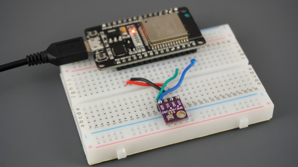

I don't know if this would be accurate enough but you could try a ESP32/ESP8266 running Tasmota with two BME280 sensors, one on each side of the filter, connected to hubitat via wifi.
The BME280's read barometric pressure, temp and humidity. Combined with Tasmota sync drivers to connect Tasmota to hubitat.
Less the $15 to try.
@ritchierich :That looks cool, but way beyond my skill level....
@kuzenkohome : Looks to be beyond my skill level.

Tasmota and a ESP32/BME280 are really simply to put together. Below is everything needed. although you would need longer wires. CAT5 cable would work.
