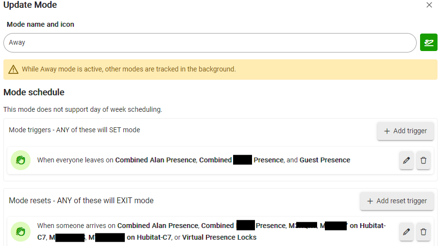

I mentioned it, but it was probably easy to miss in a long answer. The 'Exit Away mode setter' is an internal app that, as far as I can tell, is how the Integrated Mode Manager's Away mode hooks into events. You phone arrival is triggering two apps. When you say "some of them I don't even know what they are" do you mean that, or the one that starts with "Action-Set" or both?
Check your "Away" mode... have you set up both of these sections?
If you don't have the 'Mode resets' populated, then the phone arriving won't do anything with the modes.
[If you don't have the 'Mode resets' section at all, then you aren't in the Away mode settings, and if that's the case I'll suggest again that Mode names and HSM mode names are different things and might need different names.]
I thought they had made the Exit Away Mode setter app read-only in a recent build to prevent confusion about where to edit the modes, but it may still be on the to-do list for Hubitat. See my previous post about it appearing to be editable here:
