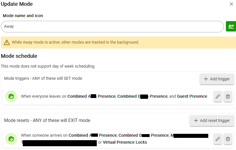

Accessing the mode manager from Settings -> Modes, I see this:
If I click the edit button next to "Away", I get this:
If I click the edit button next to the reset trigger, I get a screen where I can update the condition:
This all works as expected. I can edit the list of presence sensor devices and click Save and it will save the new list.

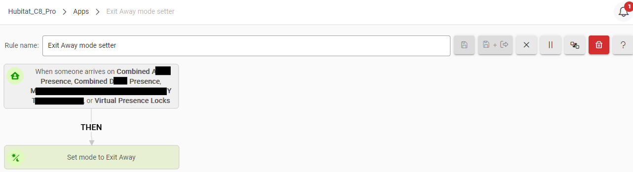

However, there is another path through the UI that looks like it allows you to edit this list, but it doesn't work. if I'm go to the "In Use By" for one of these devices:
and then click "Exit Away mode setter", I get this:
If I click on the first box, I get a pop-up with an Edit option. If I click 'Edit', this pops up:
If I click 'Clear', I get this:
If I then click "Presence Sensor", select one or more presence sensors, click 'Next', select 'Someone arrives', and click "Save", I end up back here:
Only 2 devices are now selected. The 'Save" and "Save + Exit" buttons are lit up. If I click either of those and then go check one of the devices that is no longer on the list, I can see that nothing was changed:
Here you can see that 'Virtual Presence Locks' is still in use by Exit Away mode setter even though it was not on the list of devices on the previous screen when I clicked the 'Save' icon. The same is true for all the other devices. If I got back to Settings -> Modes, the list of devices in 'Mode resets - ANY of these will EXIT mode' is unchanged.
Noted, these mode setters will appear read only in the next build.
