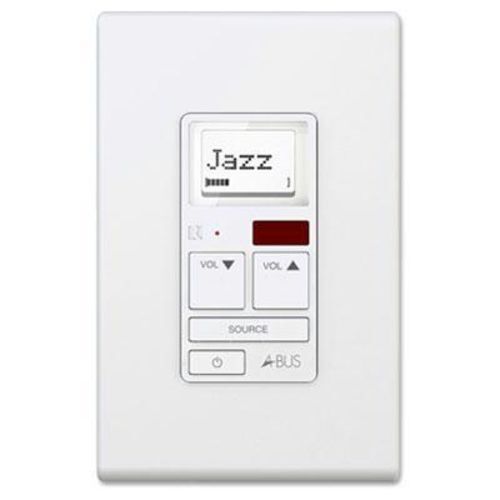

Originally the thinking is that an audio source keypad like this would be there:
abus_keypad
But central audio is a thing of the past.
I suppose I could find another POE keypad that actually has use in a modern smart home....
