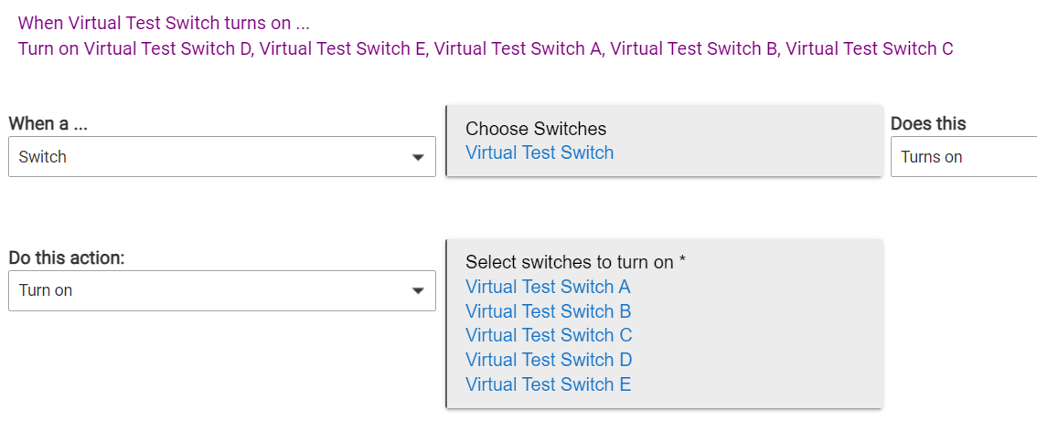

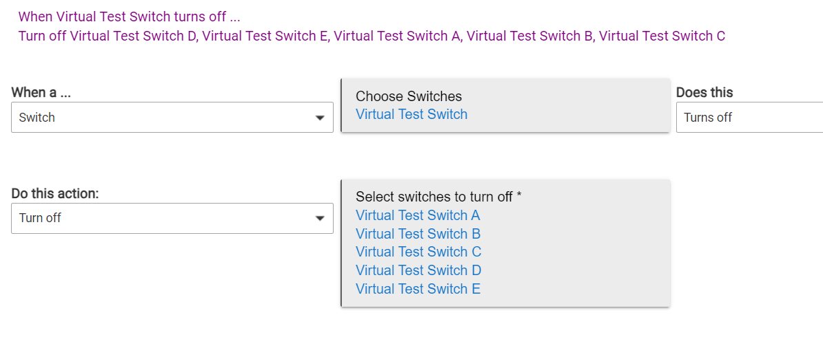

  2. Create two simple rules. I used basic rules to create one for on and another for the off version.

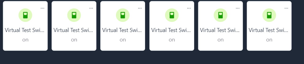

  3. For easy debugging/testing, I created an EZ dashboard with the 6 switches on it.

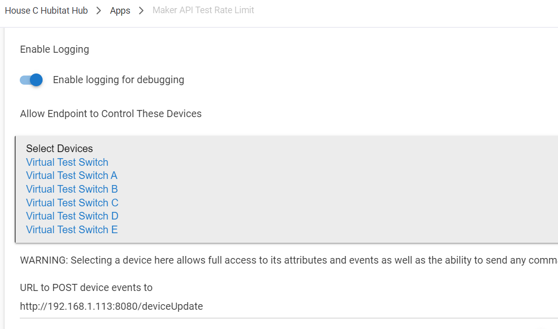

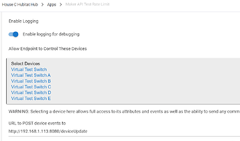

  4. Add a new Maker API instance. Add the 6 virtual test switches to it. Turn logging for debugging on. Add your test server machine's ip address and listening port in the Post device events field. I used 8080 in this example.

  6. On the dashboard, if you click the controlling device, you should see the other 5 change state as expected due to the Basic Rules. All good.

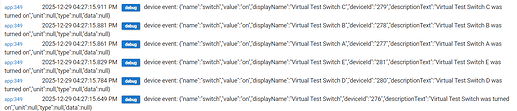

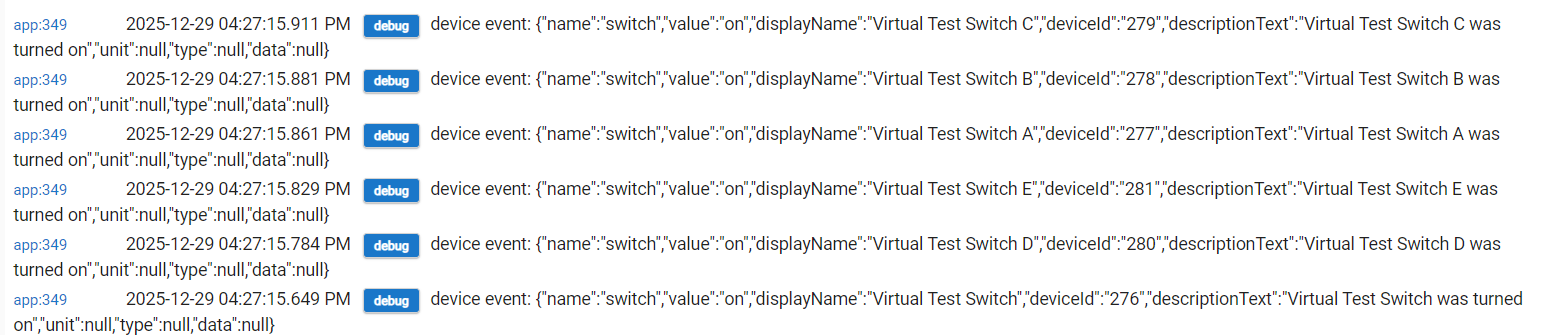

  1. If you check the logs tab for your new Maker API instance, it does appear that Maker API noted the new state and built events for each to be sent out.
  2. The ncat data received on the server side seems to align with this, it logged it in order of Virtual Switch, Switch D, Switch E, Switch A. But B and C were never received in ncat.
