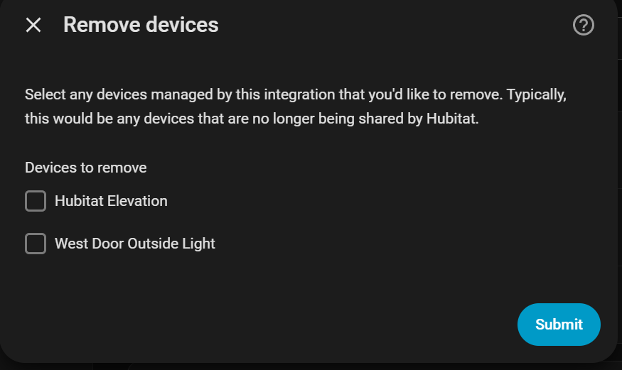

I figured this out - on the Configure link, it is multiple pages. I hit submit on the first page, and it then showed a second page for devices to remove. I thought Submit mean that was all the options, confusing UI is all.

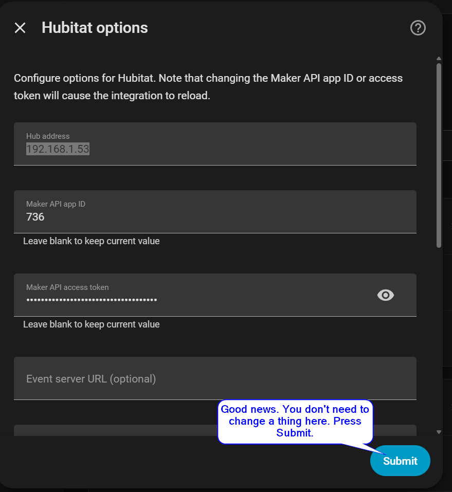

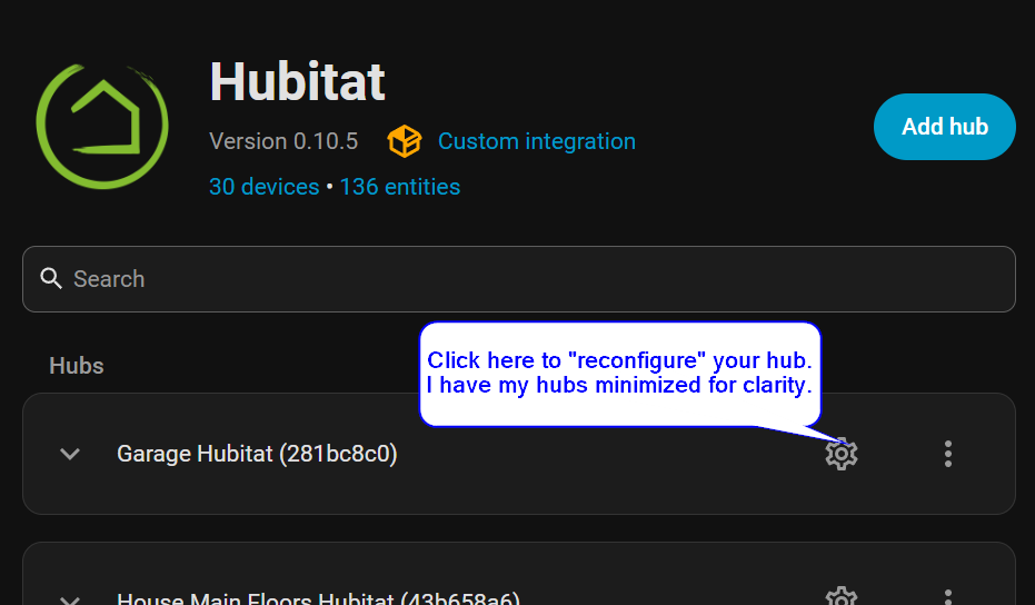

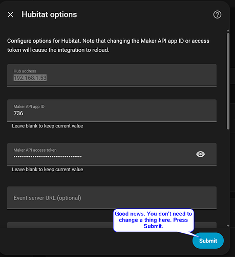

Breadcrumbs in case I go through this again and forget. It’s easy once you see the path, but I didn’t at first. From Integrations, select the Hubitat integration. Then,
  1. Re-configure the hub from which you wish to remove devices.
  1. Click Submit to move through what you’ve already setup. The configuration options are sticky. No need to change anything if it’s already setup.
  1. Remove any devices you want. One of my hubs was such a mess I unscrewed all the hub’s device names, then removed all devices from HA, and reloaded the integration.
