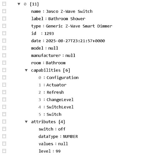

Yeah, the order of the devices is what I'm referring to. In the screenshot below, I would use 0.attributes.switch to obtain the state of the switch. This is how I've always done it because it's always worked for me with every other API I've interacted.
So, how would I obtain that same value in a way that would work regardless of where in the array that device might end up?
