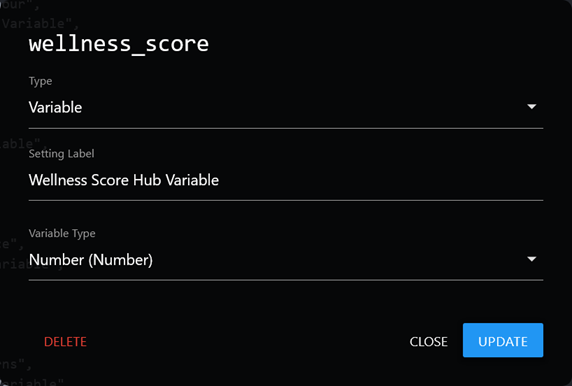

Is it correct that if I hard code Parent/Child Groovy apps. (or create Rule Machine rules for that matter) that declare & manipulate hub variables to perform variable math, set variable values, etc. I ALWAYS have to manually add the same variables within Hubitat Settings/Variables simultaneously as well.
@josh - In order to properly integrate Hubitat hub variables directly with SharpTools (stio?)using only the Hubitat Hub Variable API (& not treating them as “connector devices” or THINGS, nor using Hubitat Maker API):
  1. If all hub variables are declared upfront in that 1st code block section at the top of a Custom tile HTML/JS/CSS file, do I also need to manually declare each variable in ShartpTools (Manage Resources/Variables) even though the 1st code block section in a Custom tile's “tile settings” already references those same variables?
  2. What is the correct naming convention that SharpTools requires those hub variables to be on order to bind/subscribe correctly? Hubitat prefers using snakecase i.e: wellness_score; I think SharpTools works with camelCase i.e: wellnessScore.
I'm hoping someone can help me demystify how to get this Hubitat/SharpTools integration up & running ... I feel I'm getting close!
