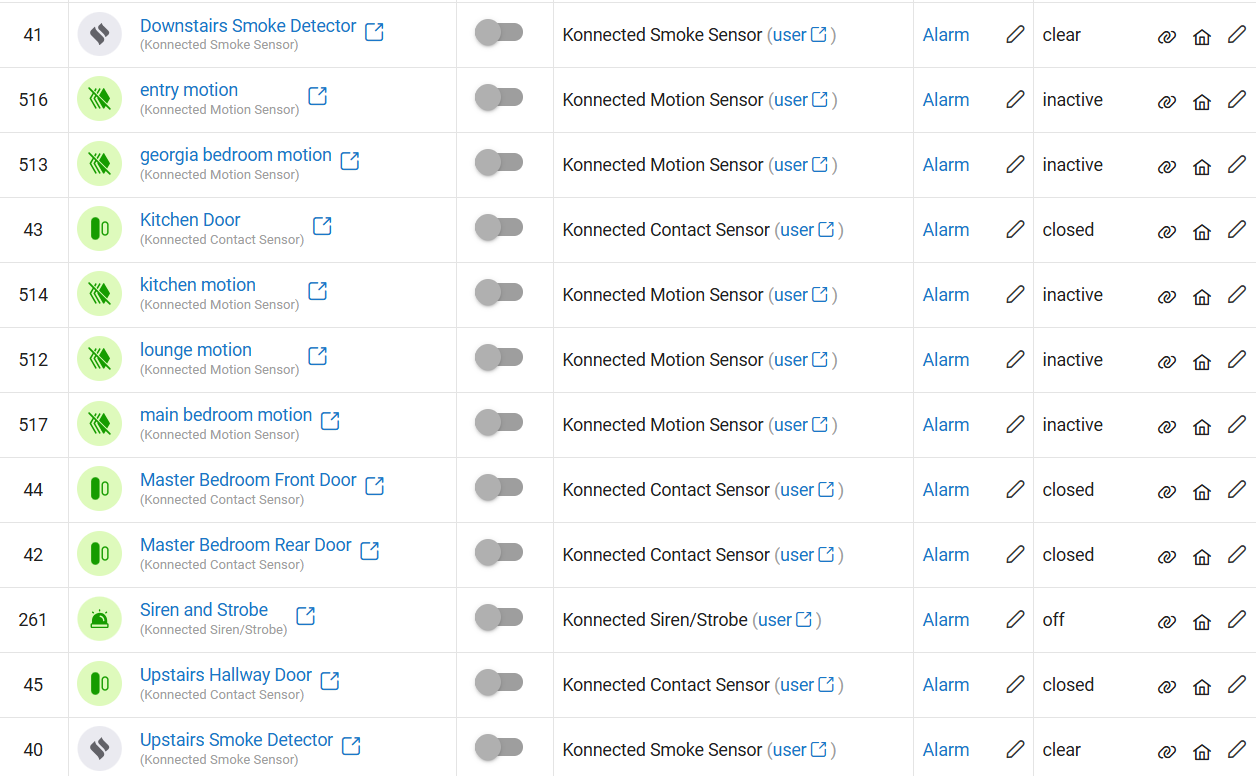

Works great, I have my "wired" reed switches, motion sensors, smoke detectors, strobe and siren integrated to Hubitat using a Konnected board.
