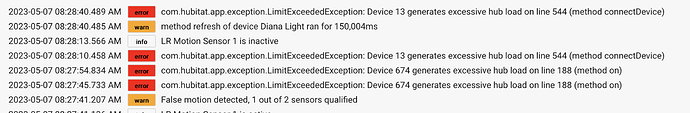

I can't get this to work. The logs just show excessive hub load which is what you mentioned about a "spammy device".

You may need to disable all of them, wait 5-10 minutes for the hub load to chill out, then try again
You could also disable them all and reboot the hub. Then re-enable and reconnect them like I mentioned above.
I will try the disable and then reboot. See what happens.
That did it. They are all working as expected. I have been using these for years and never encountered this problem. Thank You for all your help. I couldn't have done it without your help.
