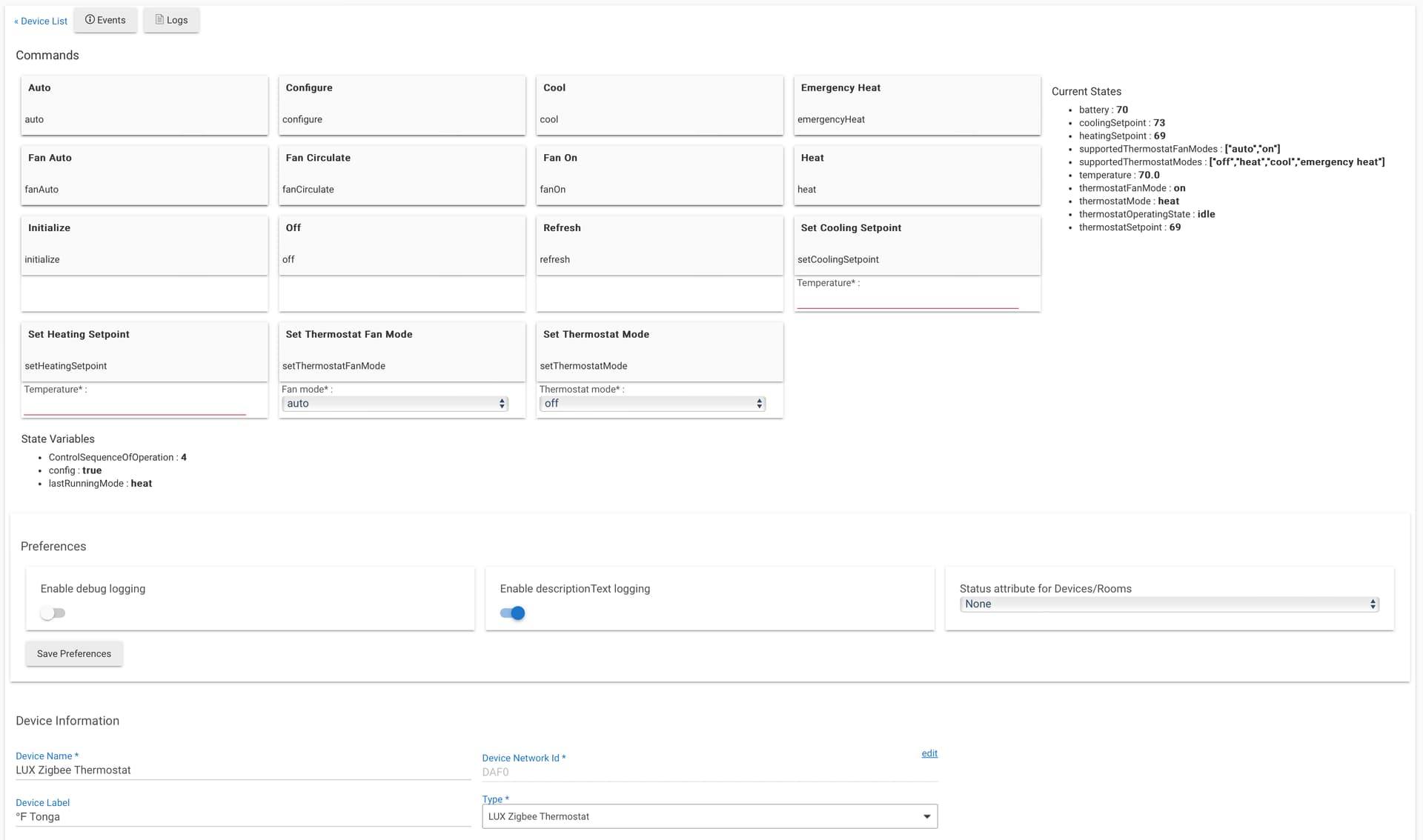

Here are the available settings.
Summary

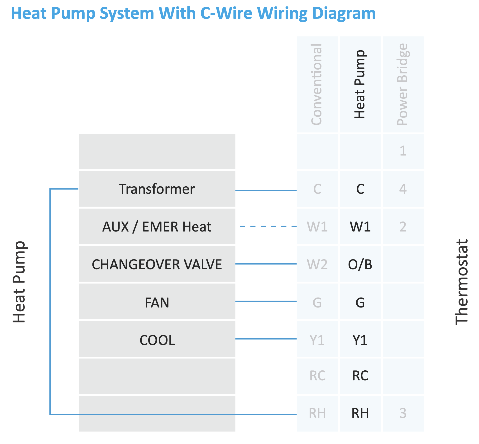

The Lux Kono (and Hubitat-controllable variants like the Konozw and Konoz) only support a single cool-stage (single Y terminal), so they cannot be used to directly control a 2-stage heat-pump.

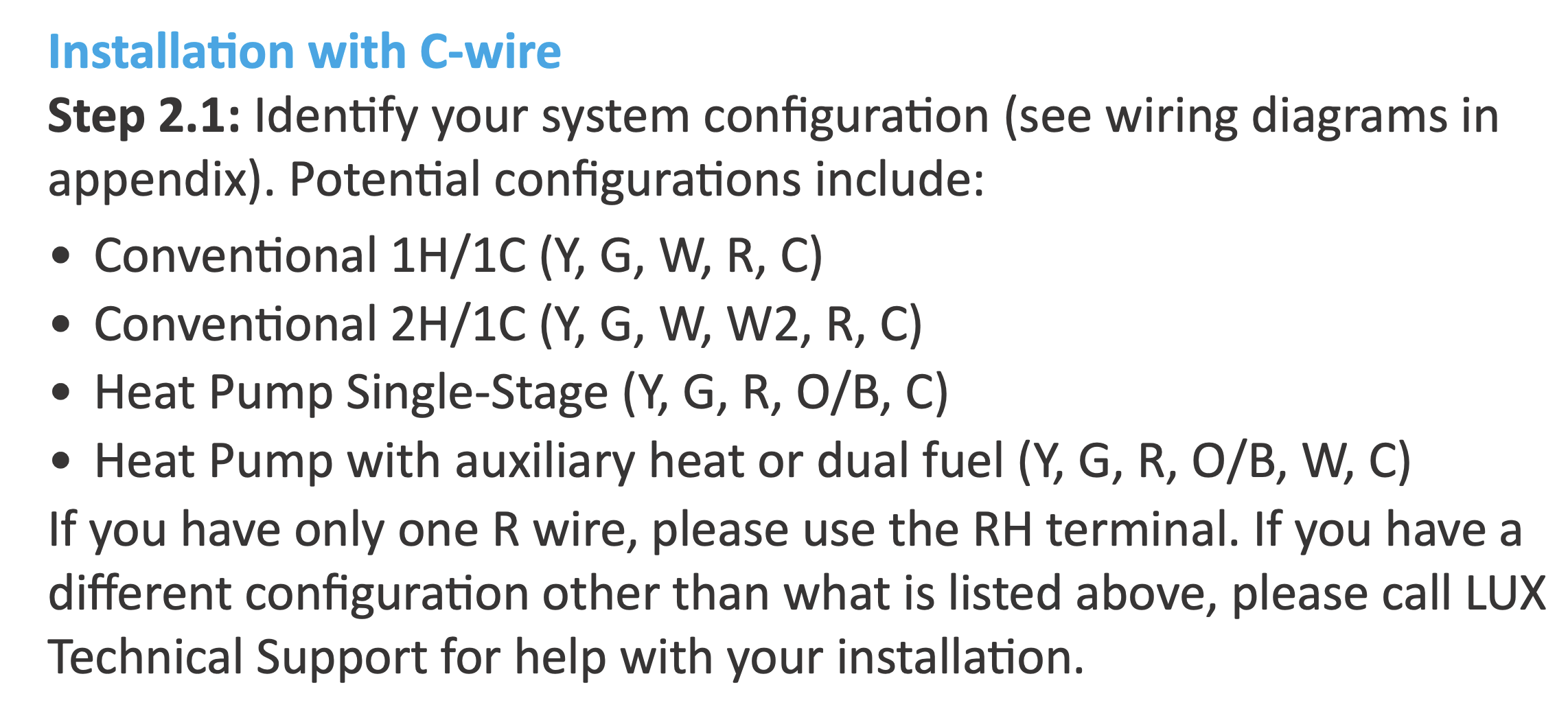

Here's the relevant portion of the installation manual:
So even with a single-stage heat-pump, they only support one AUX heating stage.
There are other Hubitat-compatible thermostats that support 2-stage heat-pumps with up to two AUX heating stages, like the GoControl, the Honeywell T6 Pro z-wave thermostat, and all the ecobee models.
