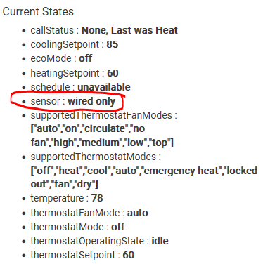

What does the sensor: wired only property of my HVAC controller mean?
It means that the optional wireless sensor isnt paired, or its offline.
It appears that one of my two Lutron wireless temperature sensors (LRF2-TWRB) battery died.
Note: both my upstairs and downstairs controllers reported status: wired only even though only the downstairs sensor battery had died.

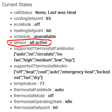

After replacing the battery the sensor value is 'all active'
but that begs the question, why isn't the wireless temperature sensor battery status being captured?
