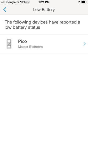

Picos do not report battery level in the Lutron app. However, there is a low battery alert.
Thank @aaiyar . So this is automatically sent if you have notifications enabled in the Lutron App?
I wonder if there is a way to get these low battery notifications to show up on my Battery Status HE Dashboard. Since I have only been using my Pico’s for just over two years now I guess I have never received these notifications given the incredible battery life on these little suckers, LOL!
That alert message is from a Pico that has been in service for 9 years. The alert appeared about 7-8 months ago. It’s still working, so I haven’t replaced the battery yet.
