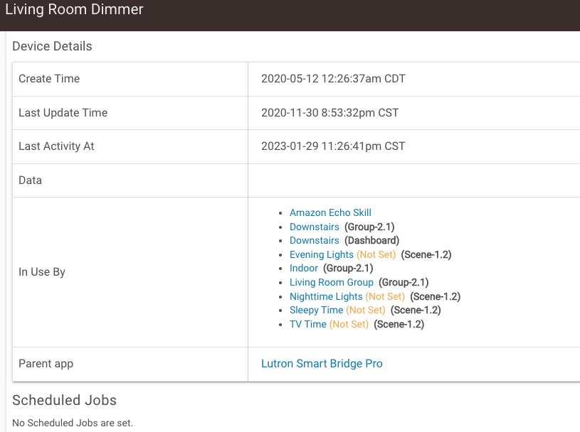

I don't see any rules that would be causing a problem under the "in use by" section of the device. I compared the device page to the other Lutron dimmer in my house and everything looks the same besides the Device Name/ Integration ID's which should be different.

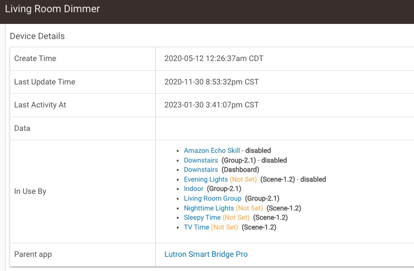

I've disabled all of the apps that the light uses and controlled it from within the device page. At first I thought everything was fine, so I turned the Echo skill back on and immediately started to have problems, so I turned that off again and everything seemed to work again. Then tried to add a scene and it started to have issues again. So I turned that scene off again. I'm pretty sure that I have turned off all of the apps that uses the light, but after a while of playing with the light in the device page, eventually I'll have the problem where the light only goes up to a certain brightness level and then when I turn it on or off, I'll get a flash.
Even though I have turned off all of the scenes and groups that the device uses, some of them do not display as "disabled" next to them in the device page. Maybe that is a clue to what is going on?
