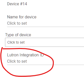

Thanks. I got it to work fine. Only thing I noticed is if you type in the wrong device number during the setup you get an error and can no longer access the setup. Is there a way to fix this to get it back or do you have to start all over again?
do you mean the incorrect device type?, like p, s, d ect?
We'd very much like to see what you mean by this. Although, please don't mess you system up.
[/quote]
Correct I do not want to create again. If you enter a Lutron Integration ID that is incorrect, you will get an error that doesnt allow you to fix.
What do you mean by "incorrect"?
A number that is not in the integration report.
That's very odd. When did it throw the error? When you entered the number or when you hit Done?
