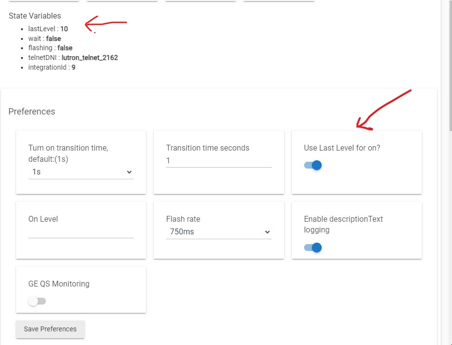

Just installed a new Lutron Diva dimmer. It works great, but I have observed a glitch.... the Use Last Level for On setting under Preferences does not work.

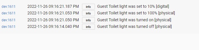

It is installed in a toilet room where I have a Room Lighting rule to dim the lights to 10% during Night mode. The means to activate is the physical switch. The problem is the dimmer comes on bright to 100%, then after a second or so dims to 10%, even though the setting under Preferences is to Use the Last Level which is 10%.

Yes, this is the way it works, these dimmers do not support turning on at the last level, so this is implemented in the driver so there is going to be a slight delay in the transition.
You may be able to minimize the delay by changing the default transition time.
