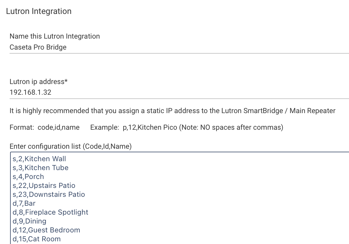

I assume you have a pro bridge 2 and are running the Lutron integration? Are any of these on the devices page on Hubitat? If not, can you snip a sample of your hubitat integration?
See attached reply. Yes, I do have Lutron Caseta L-BDGPRO2-WH - SmartBridge Pro
Your screenshot show that you have imported all of your Caséta devices as switches, and not dimmers.
Switches are binary (on/off) whereas dimmers are not (dim levels from 0-99%); because your devices are imported as switches, none of them are available as dimmers for Hubitat apps. Here's a small portion of my Lutron integration - notice the distinction between switches (s) and dimmers (d) in the Lutron integrator app?
I think you need to redo your Lutron integrator app setup.
Damn, @aaiyar beat me to it. Yes, it's because they're all coming through as switches. Dimmers use the d,#,name format and switches use s. Fix that, it should update your device page and then show dimmers.

No, the issue is your integration configuration. See @aaiyar pic. In that box anything that you have as a dimmer needs to be changed from an s to a d (case sensitive). This will correct everything.

The documentation has instructions on how to create a new Caséta/RadioRA2/RA2Select integration. When you add devices, you need to manually select the device type to be "s" (switch), "d" (dimmer), "p" (pico) etc. It is this step that your configuration has been done incorrectly.
Should be simple to correct!
Your guidance worked. It works fine changing s to d. Thank you again for your patience and support.
