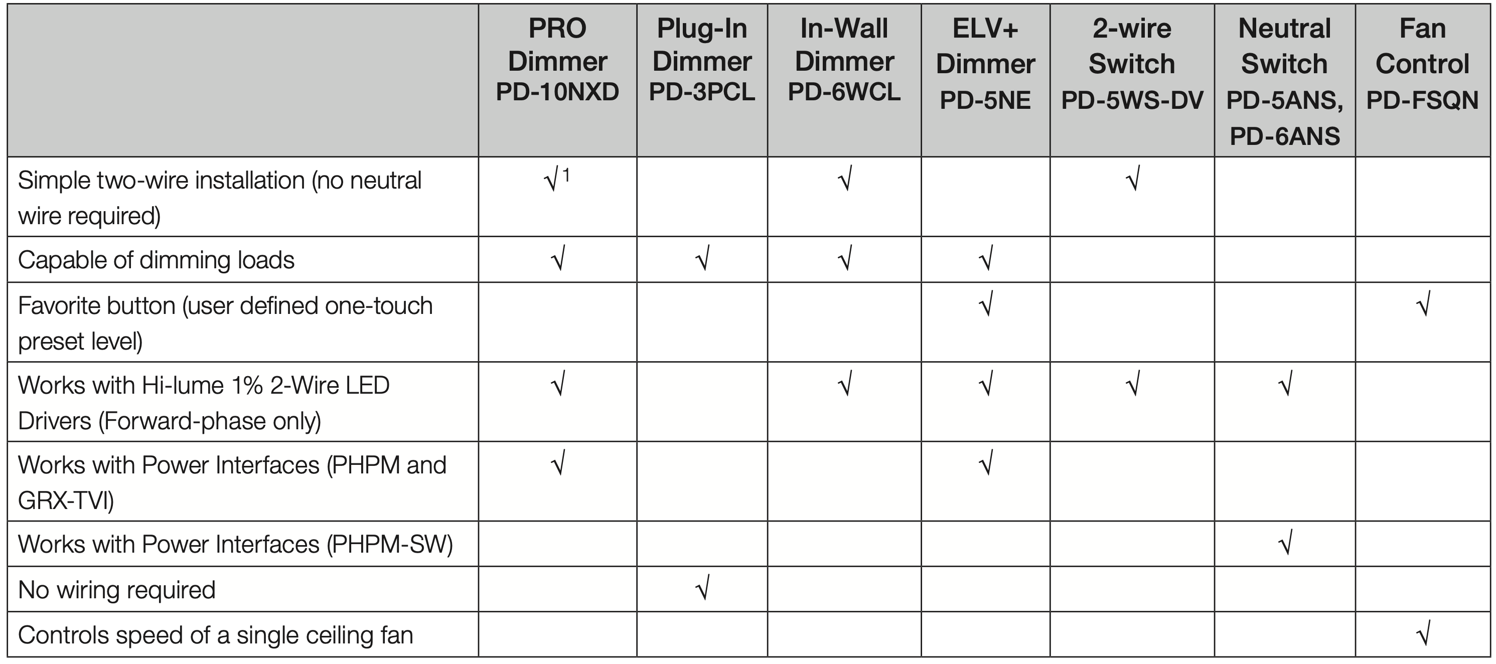

Thanks @SmartHomePrimer. Looks like both switches are offered on Amazon, but the Pro is over 2x the cost. I'm going to guess by the popularity of the non-pro dimmers that those would be fine to use and that the pro dimmers mentioned here are not worth the extra cost. Is that fair to say?
Yes, I believe there are some caseta “pro” switches and/or dimmers, but that is purely a marketing distinction.
As long as you have a Caseta pro bridge (L-BDGPRO2), you can use any switch or device with Caseta in its name, regardless of whether it also says “pro” or not in the name, and it’ll integrate with Hubitat.
Yes, in general that is fair to say. There may be some very specific situations that could require one of the high-end Caseta "Pro" switches or dimmers, for specific lighting dimmer loads, or the need for a no-neutral 'switch'.
I know there is a high-end Caseta Dimmer that includes the round "favorite" button in the middle, if that is important to you. It allows the dimmer to come on at a prescribed level, instead of 100%.
