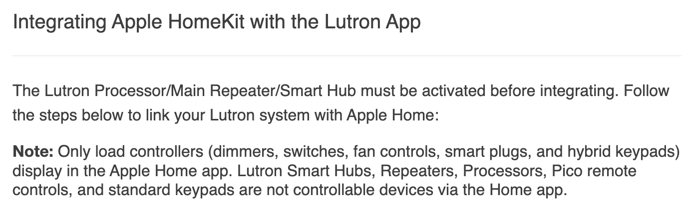

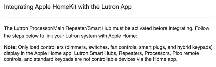

FWIW, I tried this with HA a while ago - dimmers and switches showed up But not Picos.
Right... it would appear that's known/intentional: Caseta Wireless | Using the App | Integrating Apple HomeKit with the Lutron App
