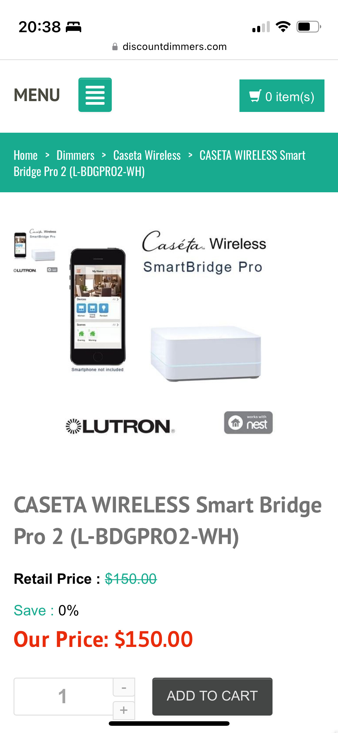

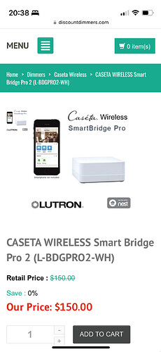

Still available from Discount Dimmers for the 0%-discounted, low, low, price of $150.
They've always been harder to find than the "regular" Bridge, FWIW. Lutron considers it a "pro" product, per the name, and restricts sale to authorized dealers and distributors, not unlike RA2 Select. At a big box store, online or in person, you're more likely to find only regular Caséta, and even online, you'll normally have to look at a bit harder for that reason.
