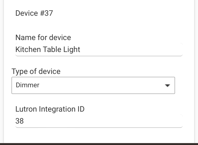

Today I added the new Caseta Diva dimmer to my system. I can control the new dimmer from the Lutron App, but I can’t control it from the Hubitat Device page. It shows up as a Hubitat device, but I can’t turn the light on or off from the device page.

Here are a few of screen shots:

Check your Lutron integration report (Lutron app Settings, Advanced, Integration, Send Integration Report). It looks like the Lutron Telnet is reporting levels for device 40 and you've assigned the new Hubitat dimmer the value of 38.
That was it!
Thank you very much!
