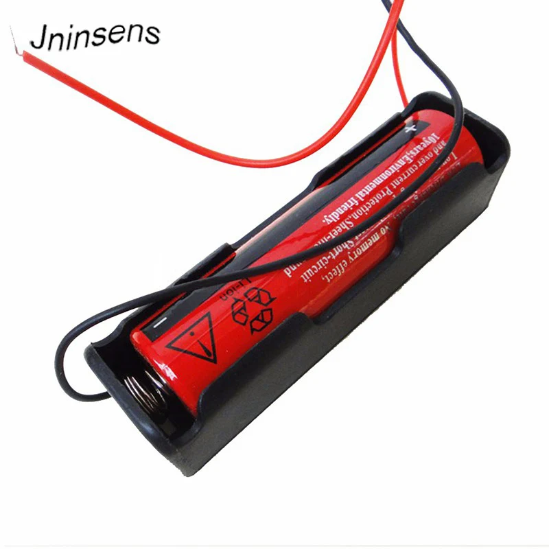

- a 18650 Li battery holder

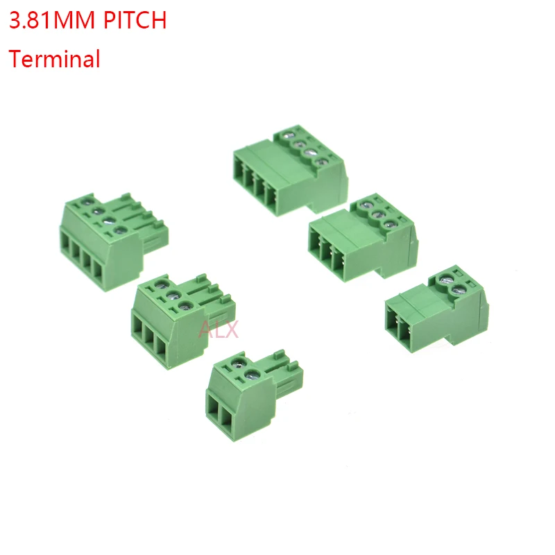

- a 15EDGRK-3.81mm 3p plug (screwable)
- 1 twisted dual wires from an ethernet cable
- an iron solder
you can screw directly the stepdown converter into the 3P plug,
you screw the wires from the battery holder to the 3P plug
you screw the ethernet cable to the 3P plug

The converter convert the variable voltage from the 18650 battery. When full, this battery is about 4.2V, probably too high for the sensor (but I didn't test this sensor under 4.2V but I thing it's not a good idea).
I put this sensor into a freezer (-18C / OF) and the voltage of the 18650 dropped 0.15 V in 3 months. That's because the battery itself is not in the freezer, thanks to the ethernet cable.
