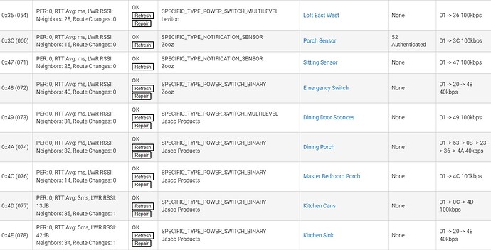

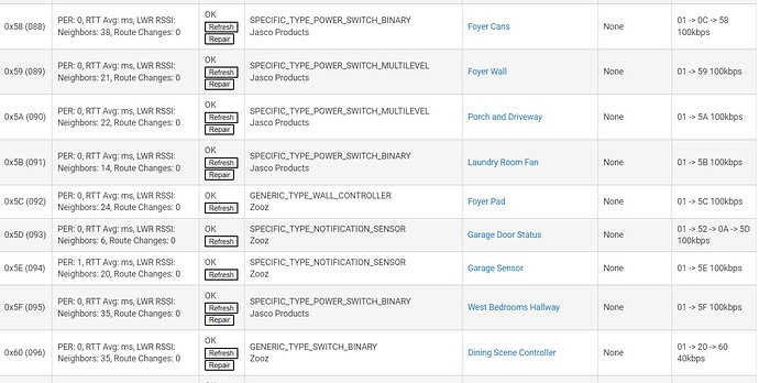

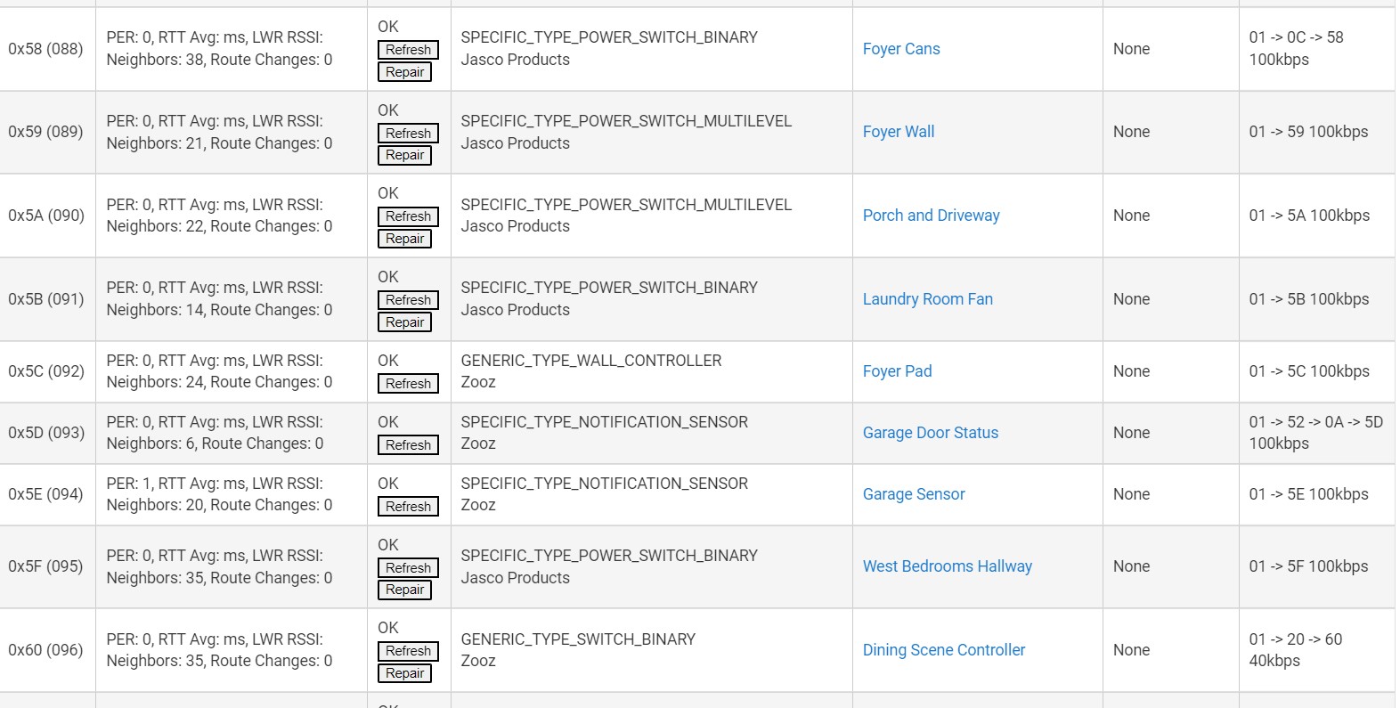

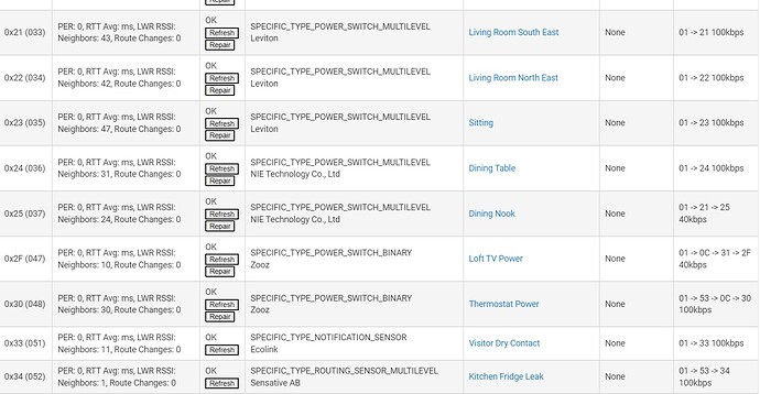

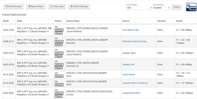

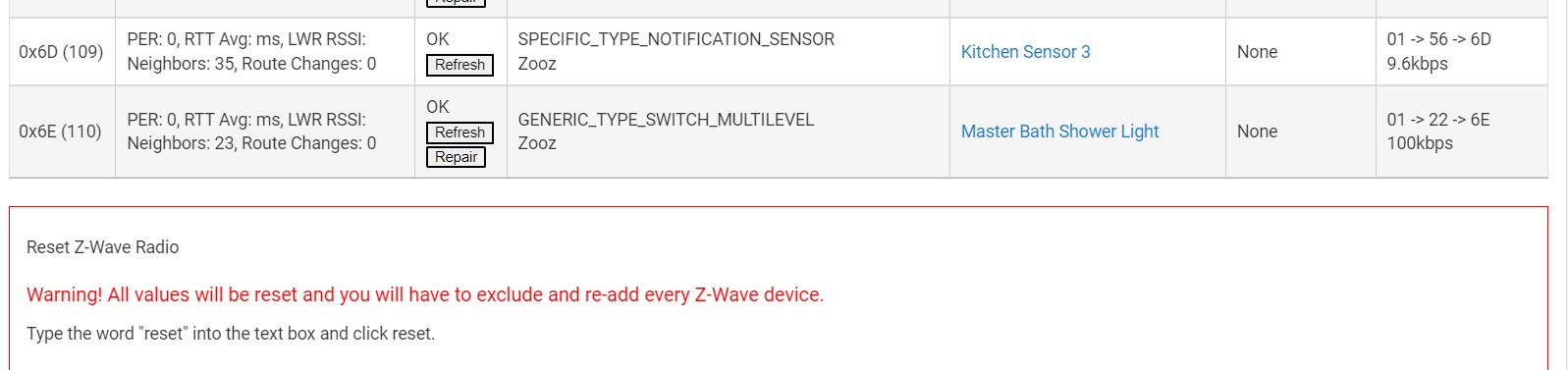

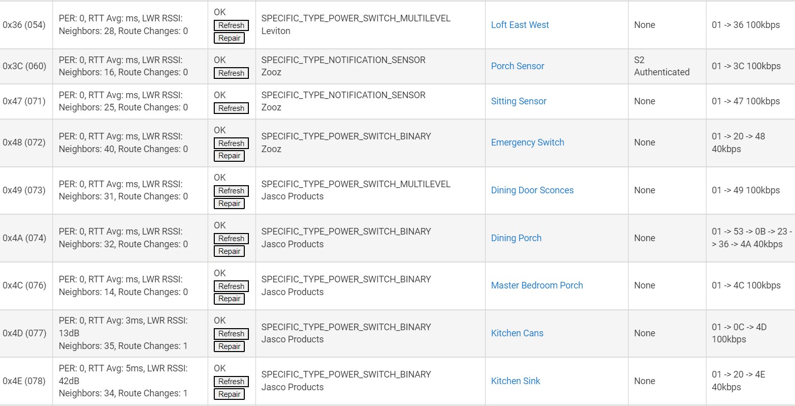

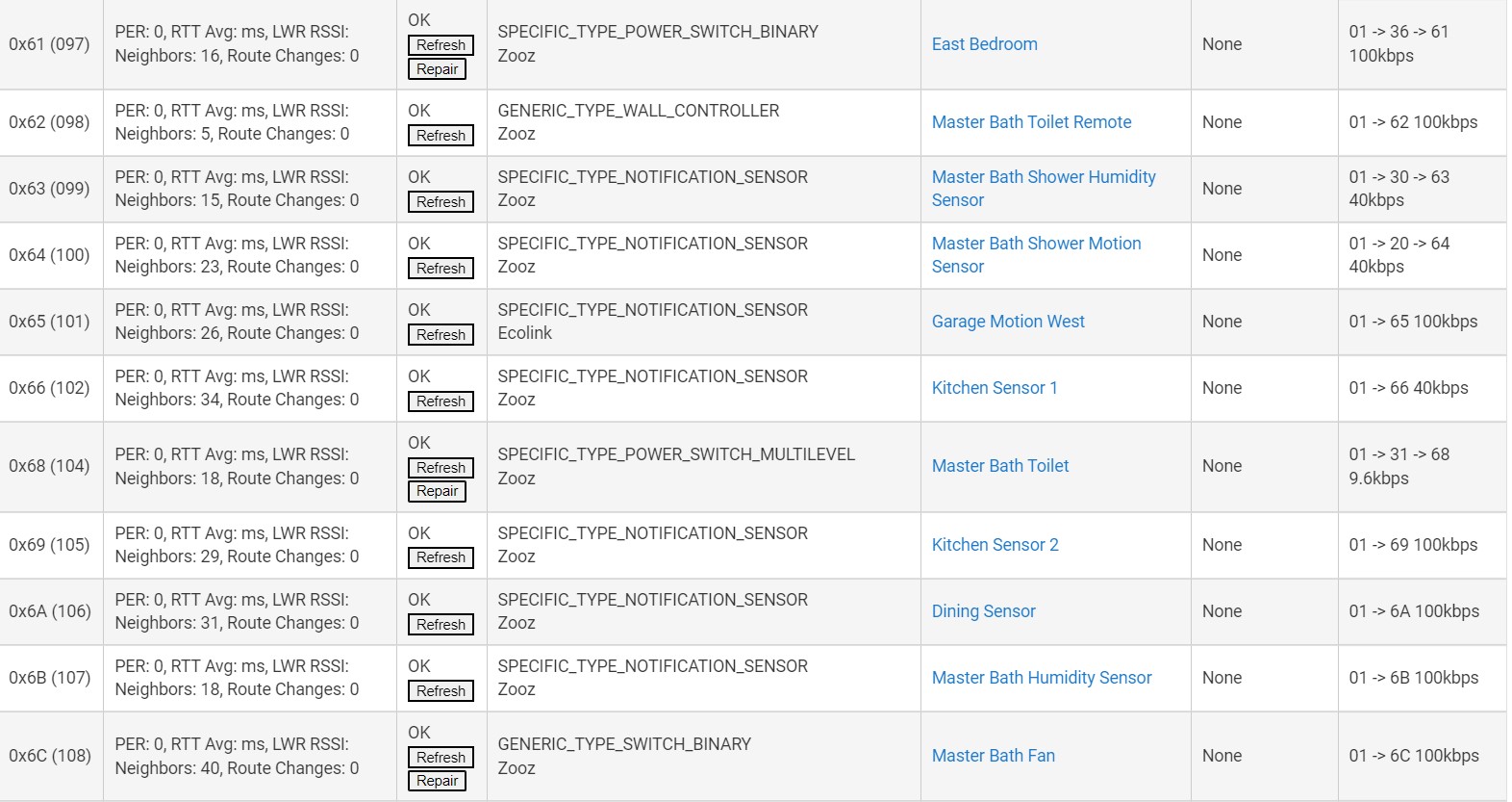

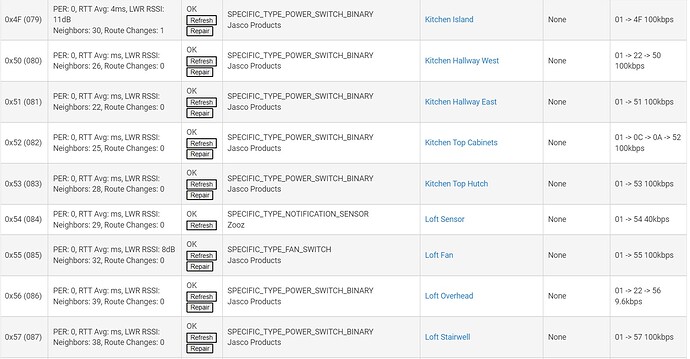

I know it sounds like a mantra around here, but can you share pics of your Z-Wave Details page?
Yes, as @danabw please post your z-wave details page.
Please find the screenshots attached Part 1
And this is part 2
You have several really low speed devices.. That could be contributing to things. That said have you done a soft reset to clean up your database?

Anything forcing your app or device stats to go through the roof? If not I'm gonna put it down to those several low speed devices
Where is device 0x31? This device reported it as its route at one point, and has a seriously low transfer rate. I would do a repair on this device to force it to rebuild its routing neighbors.
