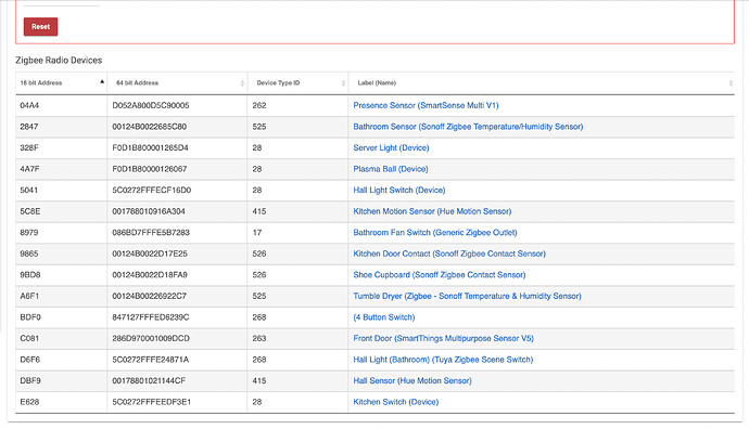

What happened when it came back up? Can you send a picture of the zwave details page?

i haven't powered it back up yet just giving it a bit more time yeah sure i'll post a screenshot

You definitely have a couple ghost devices on your zwave mesh... not sure if it's related to this or not. An upgrade would deifnitely NOT cause ghosts.
You have two ghosts in your z-wave table. This will cause problems.
i only have two z-wave devices in my home both are aeotec, one is a tri motion sensor and the other is a temp/ humidity sensor.
ZWave table shows 3, 0x06 appears to be a failed pairing of the motion sensor; 0x08 isn't showing any routes so it may be an incomplete pairing or a ghost...
6 and 8 don't have routes. They're essentially ghosts. I would exclude them, factory reset them and then re pair them.... Ghosts will slow your stuff down
