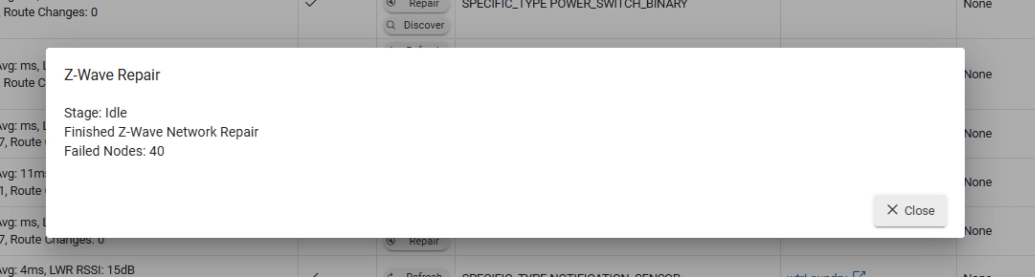

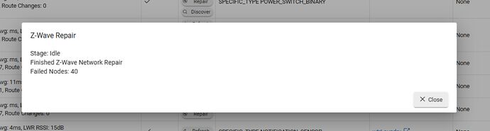

The majority of my devices are Zooz, but I do have a few GE/Jasco motion sensor switches, and having spot checked several devices, none of the Z-Wave devices are responding to hub commands. It does look like my wife physically turned on a dimmer switch, and the hub received that updated status. I ran a Z-Wave Repair on a couple of devices, and it returned a Failed message.
