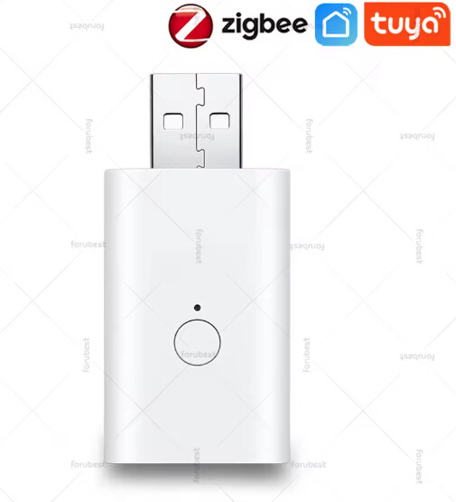

The Tuya USB repeaters are nice as you can easily position them out of sight.
AliExpress item 1005007798924350
These are my favorites.
