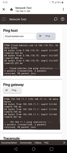

What weird is the hub is online. The hub can ping cloudflare as well as cloud.Hubitat.Com but nothing can get to the hub through the Hubitat Cloud.

Net and dns are fine

Thats not my issue if yot look at my posts u will see dns is working fine when i have no cloud access. Its boggles my mind why you REFUSE to look at my engineering logs when i can induce a loss of cloud access at will
