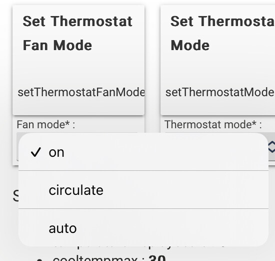

Right now, only ā€œautoā€, ā€œcirculateā€ and ā€œonā€ are available.

Rule pulls supportedThermostatFanModes from the driver. If that's missing, it has a default list that it uses. You've got the default list, so you probably have a defective driver.

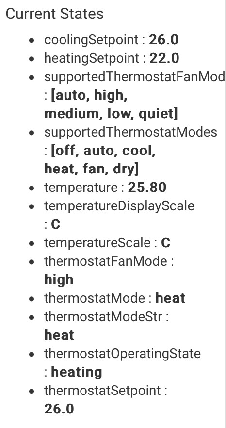

@Sebastien show the Current States from the device page for this thermostat.

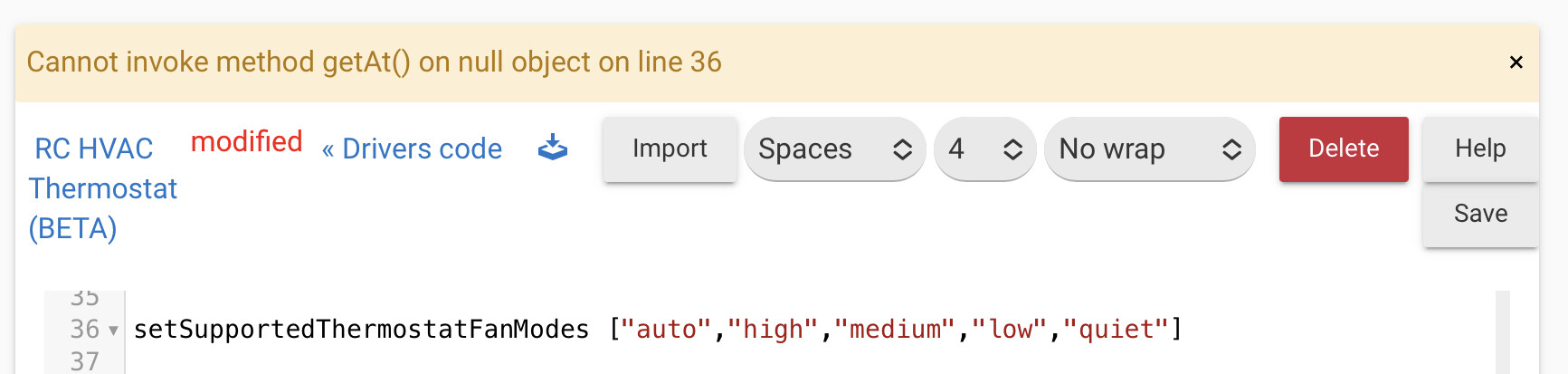

I can do Groovy cut and paste pretty well, but adding something totally new is apparently not my strong point… I thought I could just add the line, but there must be some syntax I’m missing…
UPDATE: Looks like I was missing an ā€œ=ā€œ sign… Good thing my son took some programming courses recently! :slight_smile:

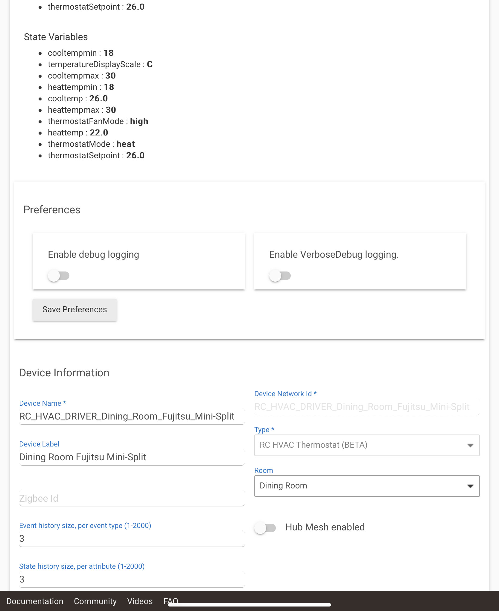

Say what? The type field of the device isn't locked when it's a child device of an app. Show a screenshot of the device page where the Device Information is displayed.
Sure!

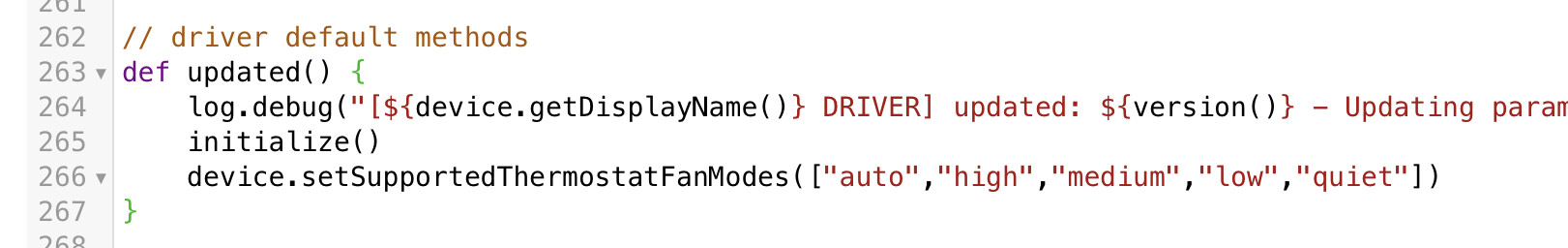

Odd, I don't see that, but then my hub isn't normal. I guess you're stuck having to update the driver. Put this in the updated method of the driver:
device.setSupportedThermostatFanModes(["auto","high","medium","low","quiet"])
I added it here:

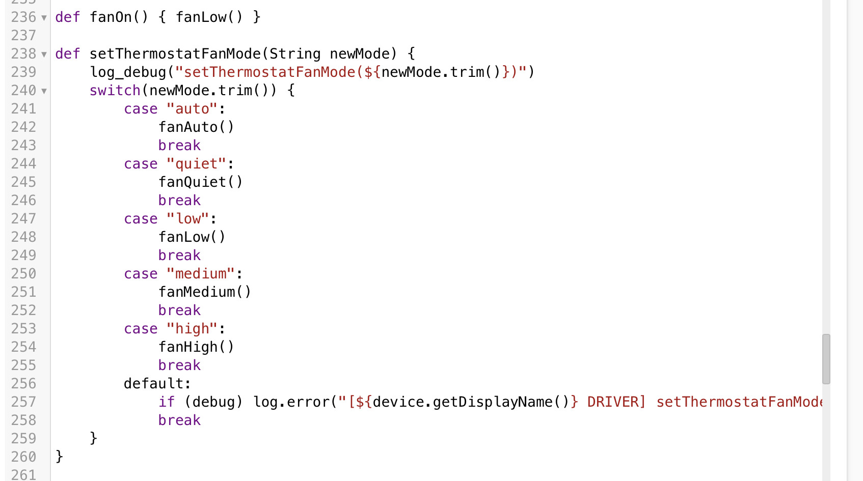

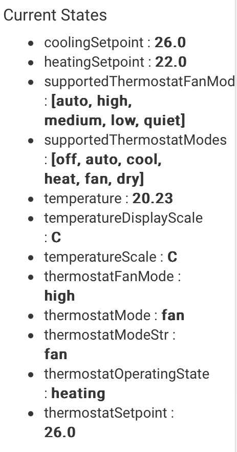

But the RM conditions aren’t showing new options. I checked the driver too and also only see:

I wonder if the following is interfering or undoing that line of code…? Commenting it out didn’t seem to fix it…
No, that code is fine. Deselect the device in RM, and then select it anew. Also, show Current States from the device page.

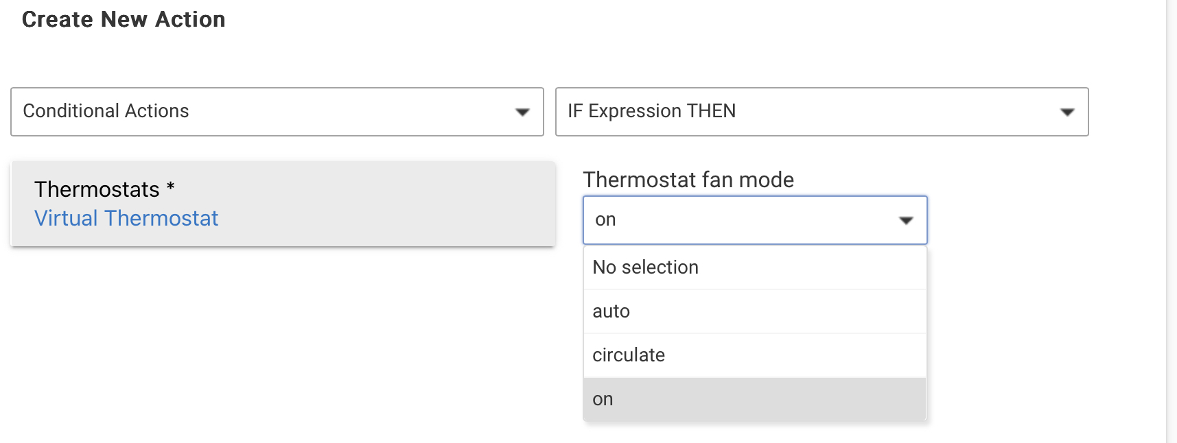

Still seeing the same as before in the curent rule, but will create a new rule with the device to see if the issue is in the rule.
No luck…

Your driver is still wrong.
Did you put that code in Updated and Hit Save Device? Maybe Save Preferences? It must show the quotes in the attribute value or it won't work.
I didn’t save device or preferences. Will do that now!
