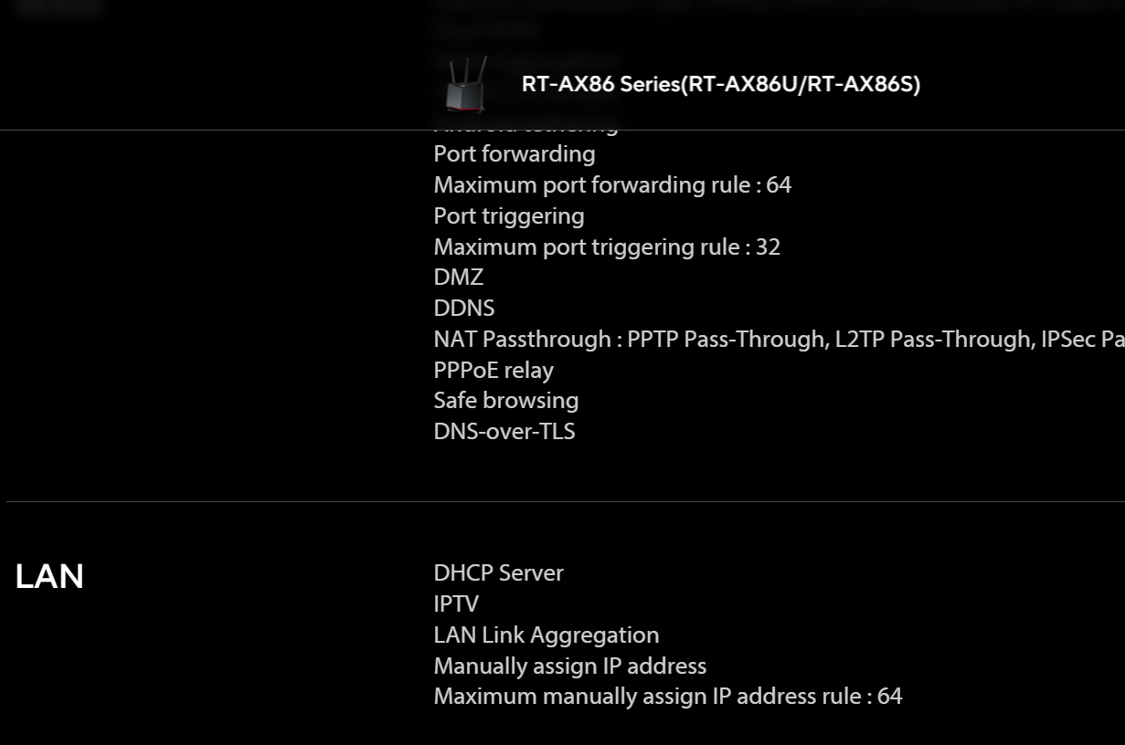

Im looking at the Asus RT-AX86s with the dual core processor which has a bit less power needs vs the AX86u quad core. I need to dig into the Antennas a bit more and also confused about the specs stating max 64 IP clients and not the usual 255.
Where do you see that? It might be a max of 64 static DHCP entries which sounds about right. But you could use any subnet you want and have over 255 clients as far as I know.
Yeah, thats probably it. 64 limited to static and other manually set allocations.
If you use the Merlin firmware I believe there are scripts that allow you to exceeded that limit if you really need to. I don't use it myself, but I think it just moves the reservation list out of the NVRAM (which is why it has a limit) and over to a file on the JFFS partition.
I only need like 30 max but I have static IPs assigned in various ranges and didnt want to reconfigure all devices, seems like a non issue.
