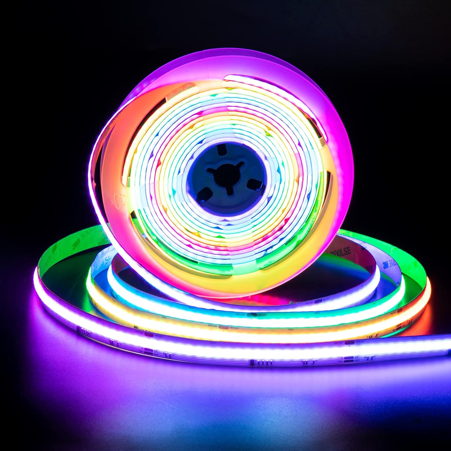

Here is my quick Amazon search (but there are many similar others):
Scroll down a little bit and you will see Clips and Power Supply
5A PS should be OK.
This strip does not have a dedicated White LED, only RGB but my experience with COB RGB color blending is very good (however not everyone is happy with just RGB without dedicated White).
