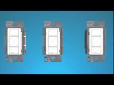

This should give you an idea of how Picos work. They are simply a remote.

The Pico can then be the button controller for the lights. Picos have a mount available that lets you mount them to the wall or over an existing switch box. You then slide the Pico onto the mount and put the switch plate on it (per my picture above). You can even mount them anywhere on a wall, put a plate over it, and it will look and can be programmed to function like a Caséta dimmer switch was there. I did this in our old house. Put the fan controller in a single gang box, mounted the Pico on the wall next to it to control the smart bulbs in the fan, and put a double gang plate over the two of them.
