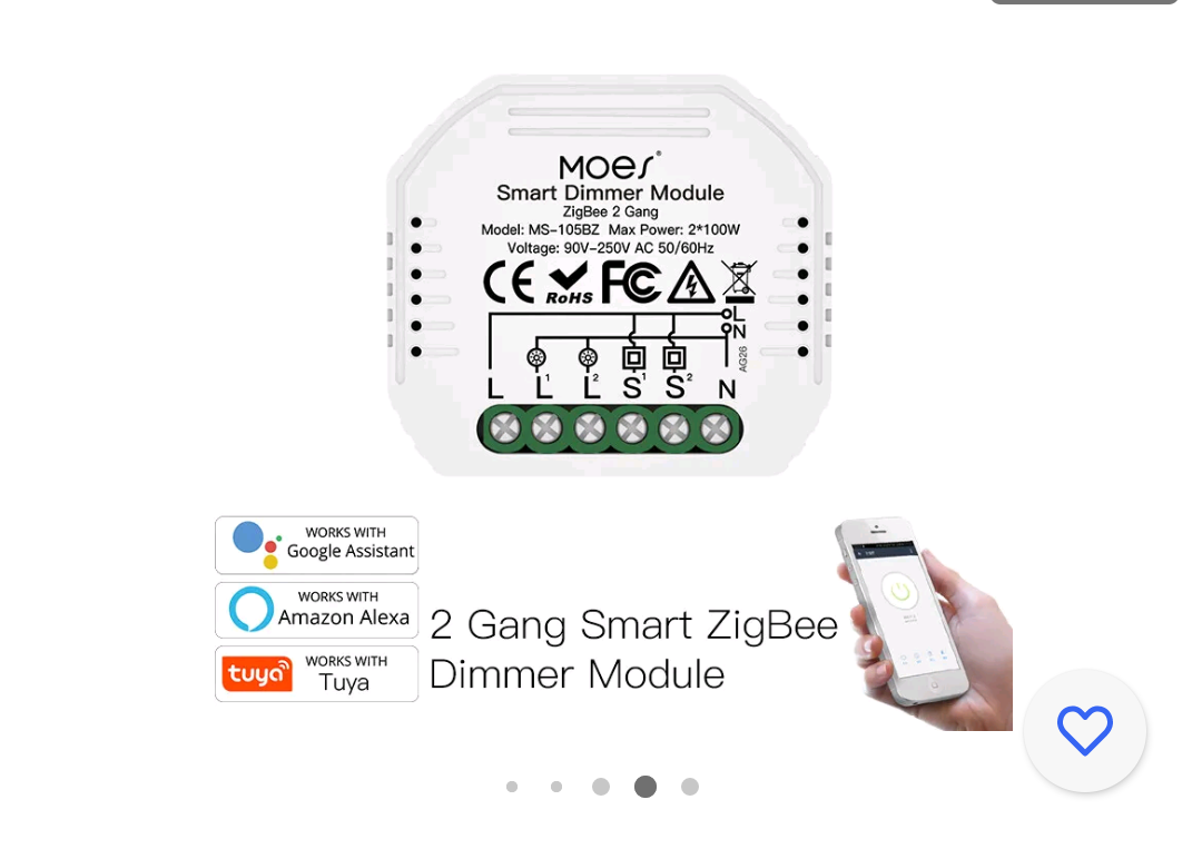

The dual in-wall relay that you linked to (shown below) should not be used with a fan. Fan speed control switches are very different from light dimmers.
Something like the one I pictured. I want separate fan control and separate light control. So when I tell Google to turn the bedroom light on fan stays on or when I tell Google to turn the fan off lights stays on or when I say turn bedroom ceiling off both go off. Is it possible. To do on the cheap side so that I can still use the light switch and no matter what position it is in control still work with Google or Hubert.
As has been mentioned, that drastically depends on your wiring and the ceiling fan itself.
If you only pull 14-2 for the fan, wall switches are out. If the motor for the fan is DC, most likely speed control from a switch is also out.
You cannot use a standard dimmer for a fan regardless. They aren't rated for that type of load.
You're trying to put the cart before the horse. If you know what fan you'll be installing, then post that here. If you know for sure that you can pull 14-3, then answer that as well and we can help.
