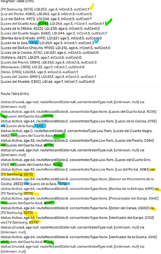

Could it be the power outage caused your router to reboot and when it did it changed the 2.4gHz WiFi channel to one that interferes with your Zigbee?
What are your Wifi & Zigbee channels?
I was thinking in that but i guess I read here in some place the normal wifi do not affect the zigbee network.. is that correct?
Anyway I have the zigbee on the default channel 20(0x14) and my router wifi in chanel 1.
Another clue is I purchased a security system, the Eufy E330, who is wifi as well but no idea what channel it use
Maybe I misunderstood; I assumed you were able to restore your network to a functional state when power had come back; I wanted to see what the neighbor table looks like in that state. The neighbor table you posted are showing that the hub has no functional bidirectional connections with any of its neighbors.
What if anything was functional at the time those screenshots were taken? I'd expect the lone end device that is a child of the hub to be working (sensor 1E8A), but that's about it.
If the neighbor table's routers always show outCost=0 for every neighbor, nothing connected to those neighbors (their child devices) will be capable of receiving routed messages.. likely the neighbor devices themselves won't be working properly either. That's why I asked what the neighbor table looks like when things are functional; to see which neighbors are carrying the routing load when things work (and to get an indication of how good their connections are to the hub from their outCost figures). If indeed that's what the neighbor table shows when things are functional I'm stumped.. those aren't valid indications for a functional mesh.
@Tony is complicated to know when all is working fine.. I guess never got all devices working properly from a long time ago.
Right now just to try I turned off my office lights (GE Switch) and it worked ok but when I tried to turn it back on it never worked, I had to turned on manually.
Note: I got electricity since yesterday night without interruption...so I guess is enough time to zigbee heal itself right?.. well it is not.... something is breaking it:
Here is my route table right now under those conditions (no office lights on it).

Ok, I moved the HE to two positions and in both of them the network worked much better. So I end thinking the problem is interferences......
Here is my route table after the change of position:
  • Some devices have a lower LQI now but still working... that will not be the final position for sure... but one thing I learned with this, is better to put HE far from other routers and magnetic fields like big TVs or switches.
Child Data:
No children
Neighbor Table Entry
[TV Samsung, 0273], LQI:253, age:4, inCost:3, outCost:1
[Luz del Portal, 40B3], LQI:253, age:3, inCost:3, outCost:5
[Luz del Baño, 49E1], LQI:244, age:3, inCost:5, outCost:7
[Luces del Cuarto Azul, 4C0E], LQI:254, age:3, inCost:1, outCost:1
[Luces de la Oficina, 4EE5], LQI:230, age:6, inCost:5, outCost:0
[Luces del Cuarto Negro, 5682], LQI:244, age:3, inCost:5, outCost:7
[Bomba de la Entrada, 6199], LQI:221, age:3, inCost:5, outCost:0
[Luces de la Sala, 7372], LQI:254, age:3, inCost:1, outCost:3
[Luces del Baño Chiquito, 9F00], LQI:212, age:6, inCost:5, outCost:0
[Luces de la Cocina, A77E], LQI:221, age:6, inCost:5, outCost:0
[Cafetera, AE21], LQI:211, age:7, inCost:5, outCost:0
[Luces del Pasillo, C084], LQI:253, age:3, inCost:3, outCost:3
[Microwave, CB58], LQI:22, age:7, inCost:7, outCost:0
[Velas, D785], LQI:253, age:3, inCost:3, outCost:1
[Luces del Jardin, D95F], LQI:253, age:3, inCost:3, outCost:7
[Luces del Mueble, E35C], LQI:66, age:7, inCost:7, outCost:0
Route Table Entry
status:Unused, age:null, routeRecordState:null, concentratorType:null, [Unknown, null] via [Unknown, null]
status:Active, age:64, routeRecordState:0, concentratorType:None, [Luces del Cuarto Azul, 4C0E] via [Luces del Cuarto Azul, 4C0E]
status:Active, age:64, routeRecordState:2, concentratorType:Low Ram, [Luces de la Cocina, A77E] via [Luces de la Sala, 7372]
status:Active, age:0, routeRecordState:2, concentratorType:Low Ram, [Luces del Cuarto Negro, 5682] via [Luces del Cuarto Azul, 4C0E]
status:Active, age:32, routeRecordState:2, concentratorType:Low Ram, [Luces del Pasillo, C084] via [Luces del Cuarto Azul, 4C0E]
status:Active, age:64, routeRecordState:2, concentratorType:Low Ram, [Luces del Cuarto Gris, 0161] via [Luces del Cuarto Azul, 4C0E]
status:Active, age:32, routeRecordState:2, concentratorType:Low Ram, [Luz del Portal, 40B3] via [TV Samsung, 0273]
status:Active, age:64, routeRecordState:0, concentratorType:None, [Sensor de Movimiento de la Cocina, 2BED] via [Luces de la Sala, 7372]
status:Active, age:64, routeRecordState:0, concentratorType:None, [Bomba de la Entrada, 6199] via [TV Samsung, 0273]
status:Active, age:64, routeRecordState:0, concentratorType:None, [Presurizador del Garaje, 554C] via [Luces del Cuarto Azul, 4C0E]
status:Active, age:64, routeRecordState:0, concentratorType:None, [Boton del Garaje, EBDD] via [TV Samsung, 0273]
status:Active, age:64, routeRecordState:0, concentratorType:None, [Ventilador del Garaje, D732] via [TV Samsung, 0273]
status:Active, age:64, routeRecordState:0, concentratorType:None, [Ventilador de la Cocina, 5515] via [Luces del Cuarto Azul, 4C0E]
THANKS A LOT TO ALL OF YOU FOR YOUR HELP ON THIS!! :muscle:
Adding repeaters will really help here. We live in a 1100 sq ft home and I ended up with at least one repeater in each room and still have some devices on the edge of the mesh that work, but the connection isn't 100% solid. It's not only the size of the home but also the construction and what's in it that makes a difference.
Whatever changes you made resulted in significant improvement; it's apparent from the increase in the number of viable routers (those with nonzero outCost figures and age counters <5). Pay attention to those devices (if they're happy your mesh will be happy).
You can see from the Route Table entries how the routing algorithm is now using those 'first hop' routers (the ones I've highlighted below) to transmit most (if not all, at least based on this snapshot in time) of the routed traffic in your mesh:
Definitely true; google 'side lobe interference'. Regardless of the channel your Zigbee mesh is using, putting it closer than 3 feet or so from WiFi router may cause issues.
Totally agree Tony...
I just moved to another room, nothing else.... and the changes was 180degress.
I am planning to move it to an even better location but I need to prepare the ethernet cables for it (simple task).
I will look for that on google for sure.. we can learn something everyday.
Thanks to you man and to all guys willing to help others on this amazing community
For sure... I have one in the last rooms just for that reason....
