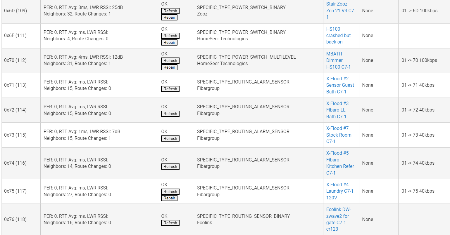

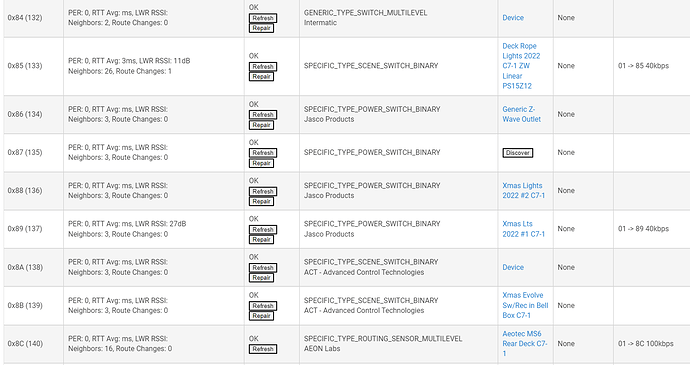

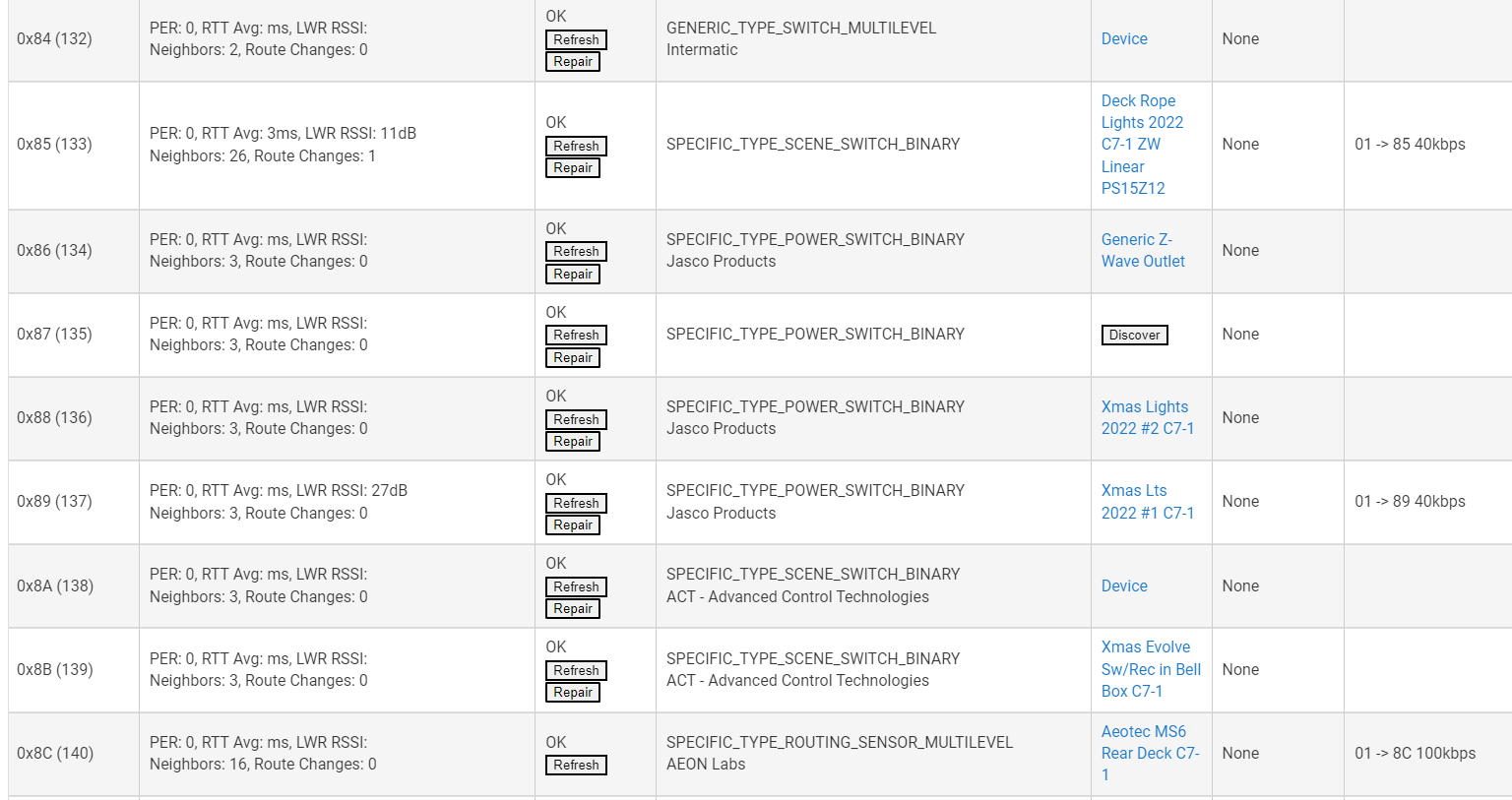

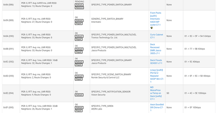

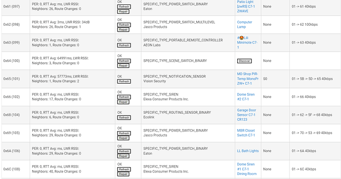

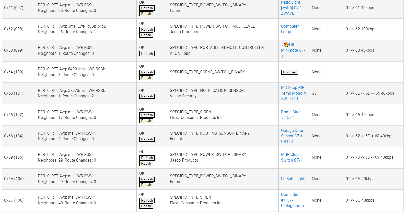

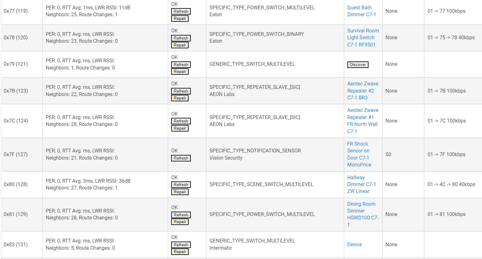

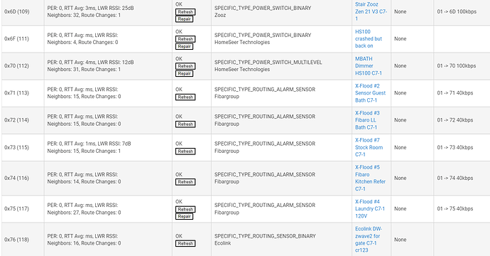

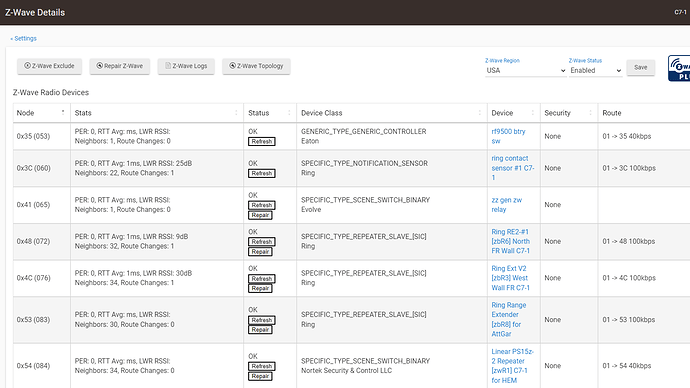

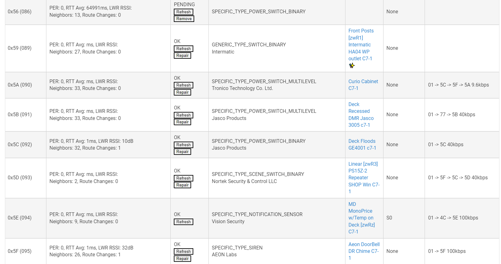

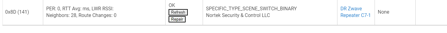

About 90% moved from my C4 and now on my C7. I'm thinking I developed some ghosts when I had failed devices on joining. Appreciate anyones comments on my zwave details pages.
Yeah you need to get rid of those ghosts. Your mesh is a mess. Others look like incomplete pairings (on my phone so can't tell if that or sleepy edge devices). Any time you have a failed pairing stop what you're doing a check for a ghost and remove it. Factory reset the device itself and attempt repairing again.
