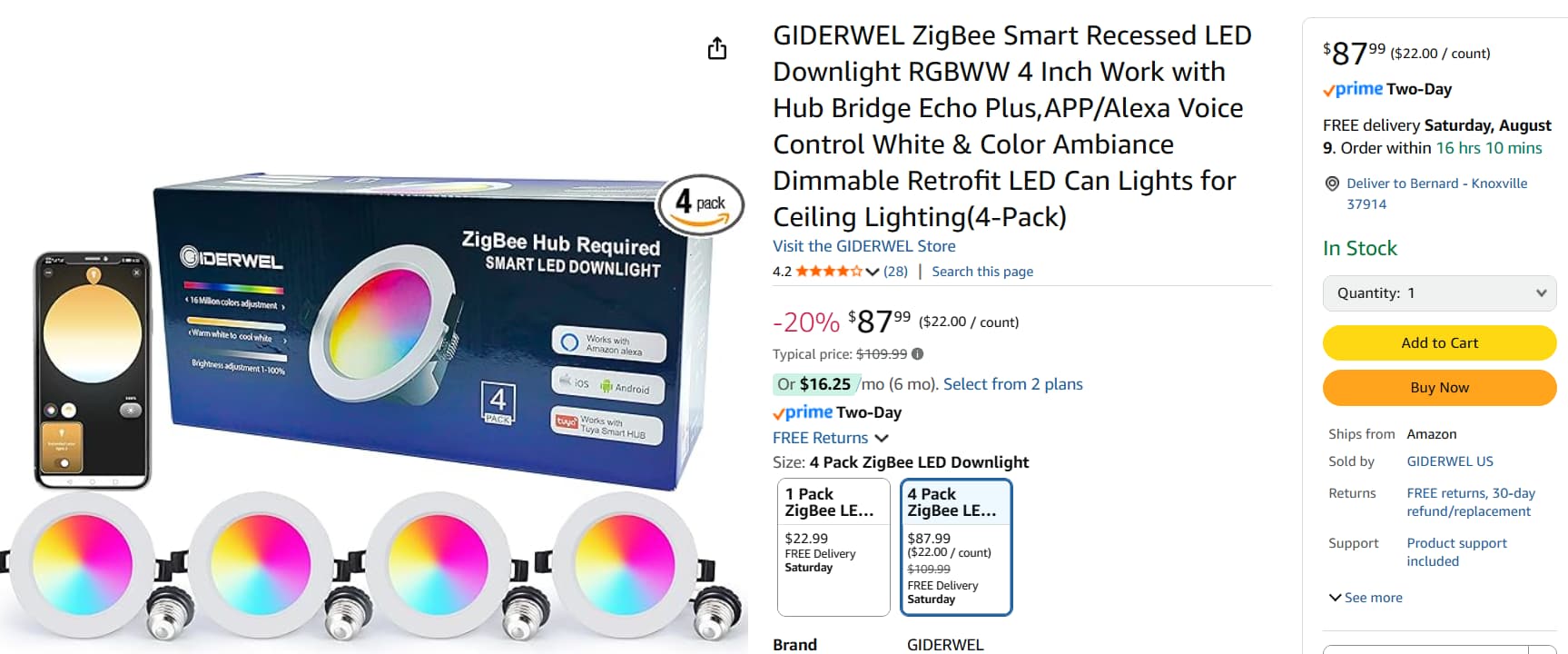

I'd like to replace my recessed ceiling lights with non-Wifi smart versions. I found the "GIDERWEL" lights shown in the picture. Can someone recommend any Hubitat compatible 4" lighting similar to this?

The fixtures in the photo screw into a pre-existing, standard E26 bulb socket. Would you consider fixtures that are wired directly?

The photo you posted is an example of smart lights that, as I said, screw into the bulb socket that’s already in the ceiling, assuming the ceiling already has recessed lighting fixtures that take bulbs with an E26 screw-in base.
