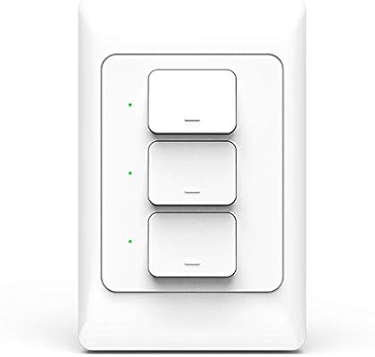

Looks like Zemismart has another 3-gang zigbee switch. Anybody happen to have it on HE?
I have those switches, and I'm about to try it out (New in HE in the migration process from ST)... I'll let you know... (i had them configured on my Phillips Hue HUB but they are not recognized when try to imported them.. So... I'm going to try it on Zigbee and let you know...
Great! Thanks.
I wonder if they still use the Nue driver? If so, are they parent/child?
Well.. I made it work...
First detected as a Generic Zigbee device, then I change the type to Nue Zigbee Switch and the other 2 gangs appear, but after that you can't change the name of the buttons...

Here at my home all of my switches are currently from Zemismart ZigBee, some of them are touch and some has physical buttons.
