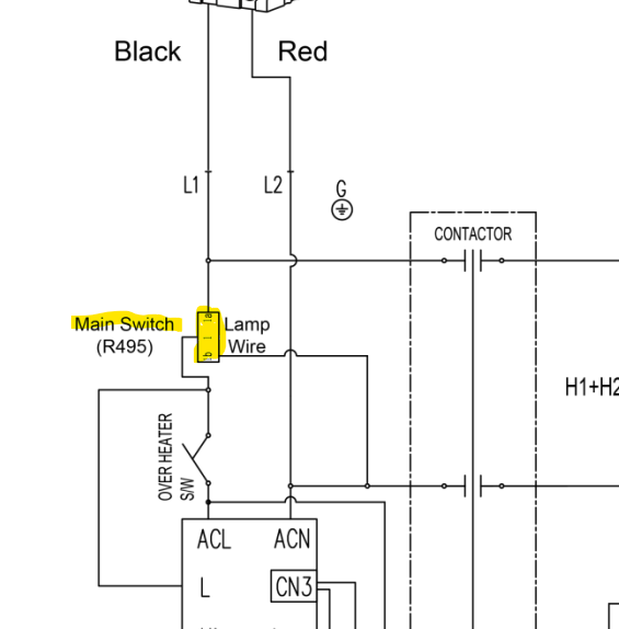

I have a Dr. Heater DR-975 7500W garage heater. I wanted to be able to remotely power it up, so I had my electrician (who installed the heater originally) put in a DEWENWILS 800 Series Z-Wave Long Range switch, 40-Amp, in series with the heater.
Then I found out that the switch can turn power ON and OFF just fine (as expected), but the HEATER does not power ON when the switch is ON -- the heater requires a manual press of the "power" button of the accompanying remote to actually turn ON.

You could also bypass that switch, if you were OK with opening the heater.
Also, what is up with the thermostat that is optional? The optional thermostat can turn it on and off, so why not use that terminal? If it was being controlled by a thermostat, nobody needs to push a button for it to come on. So a simple relay device on Terminal A could be used as a switch.
This also has a wired thermostat option. That's the angle I would take. Wire up a relay to the leads for the thermostat.

Internally there is a contactor.
