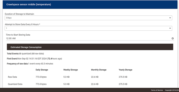

It doesn't look like they are setup for a week. The first and last event are on the same day. CLick the select device data then click NEXT without changing anything and that page will show you the length of data to capture.
Also your sensor names may be an issue, I know webcore has trouble with names that have a apostrophe(') in them, so not sure about a slash(/)
In your screenshot it doesn't show the sensor name(The blue bar across the top of my screenshot). Is that because you cut it off in your screenshot? That is what happens when it has issues with the name you don't see the sensor name above, so you may not be editing what you think you are.
