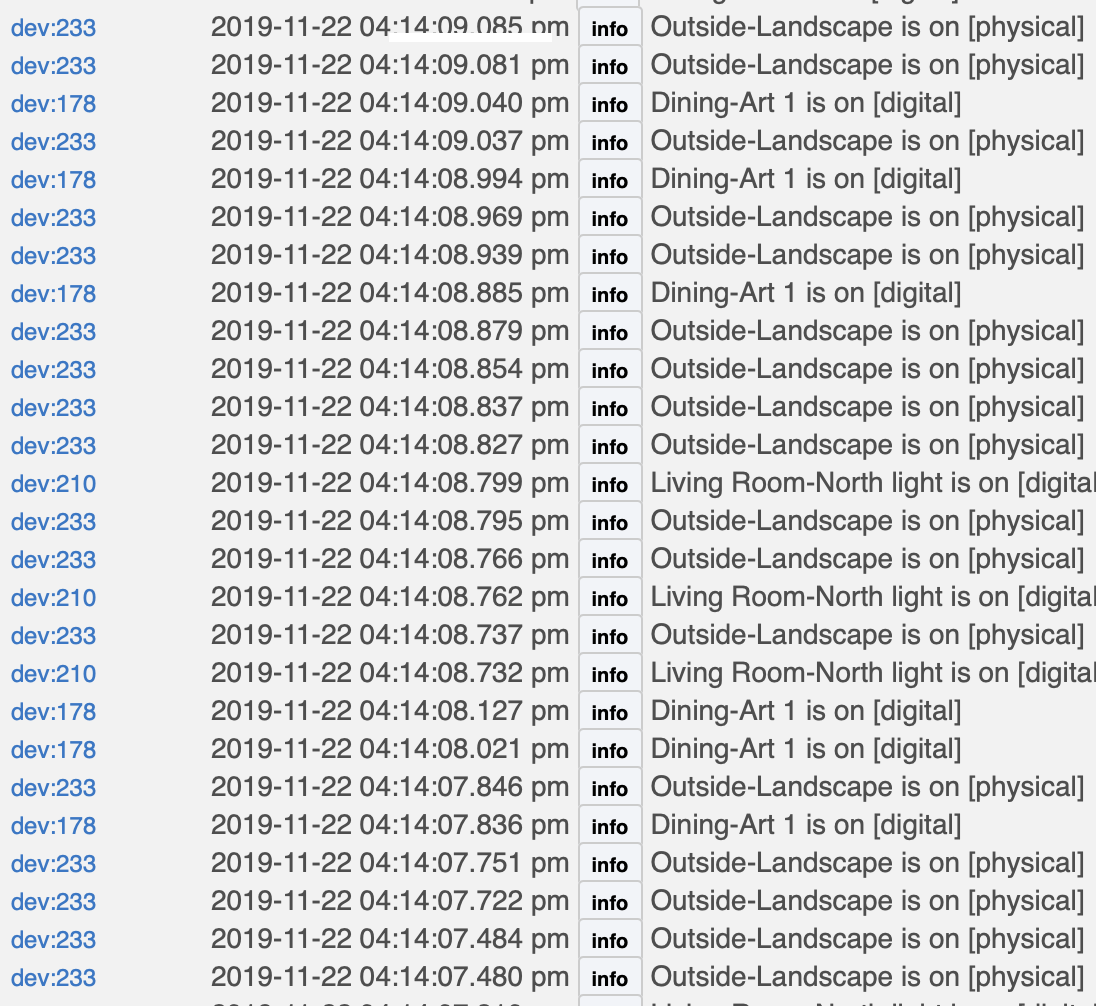

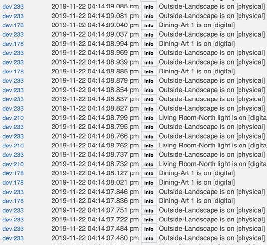

When I review the logs I see repeated log entries for the same item separated by a small fraction of second for the same action. Is that expected or is this an indication of a problem I must solve?
What type of devices are these? Make and Model? Zigbee, Z-Wave, or Wi-Fi?
Outside Landscape lights is a GE/Jasco z-wave switch
Dining Art is a GE/Jasco z-wave Plug
Living room North light is GE/Jasco z-wave plug
Are you running the Z-Wave Poller by any chance? If yes, try disabling it to see if things calm down.
The only thing I have is a range extender from Aeotec. To me the log are quite noisy which also could the cause of the appearance the hub is not as fast as hoped. In my mesh I actually have 80 devices most are z-wave, One or two Zigbee and eight Hue lights which are first generation,
