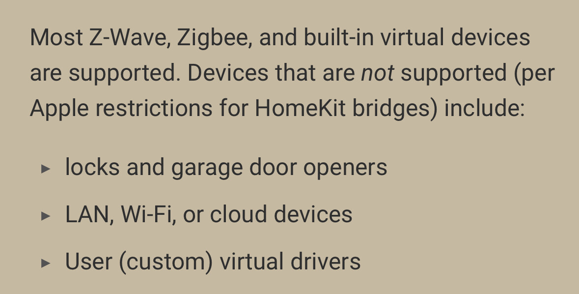

Apple doesn’t allow certain classes of devices paired to certified HomeKit bridges to be exposed in the iOS Home app.
Hubitat is in the process of becoming a certified bridge.
From the hub’s new documentation page on the HomeKit integration:

Hubitat can bridge dozens (or hundreds) of devices. Apple imposes different requirements on that kind of bridge.
Correct. It's Apple. But you can make a virtual switch and export that and then control the "switch" behavior on the Hubitat side.

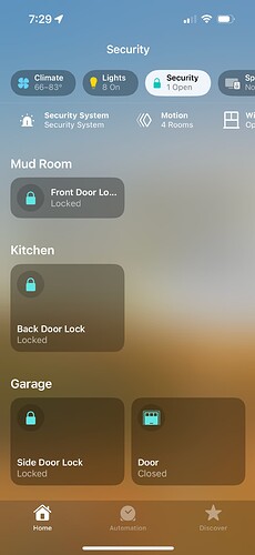

Not an ideal workaround, unfortunately, because in the Apple Home app, locks are locks and switches are switches.
Locks show up as “security” devices, switches do not.
Hopefully Apple will eventually change their mind re: the current set of restrictions.
Until then, uncertified bridges like Homebridge will still have their place. That’s how I get my Hubitat-connected locks (and garage door opener, also restricted by Apple) into the iOS Home app.
