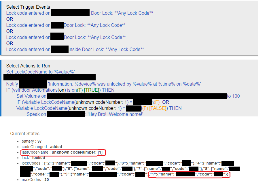

I've noticed that when I trigger on "Lock code entered on xxx door lock Any Lock Code", then examine the "%value%" in the event, that is set to "unknown codeNumber: 1" improperly.
This seems to happen because the "lockCodes" list has entry "1" in OTHER than the first slot in the array.
This is the result of having issues with the Lock Code Manger and adding that code back in after deleting code "1" before. It's improper to assume that list is "in order".
This happened with the "Schlage BE468/BE469 Lock" driver that came built-in. I know those drivers and support for the locks is sketchy--but this seems to be a (hopefully) fairly simple coding oversight. And, I'm not sure if it's driver related (maybe Lock Code Manager or an RM issue).

I did, as you can see.
Lock code 1 is in use and has been given a name. You can see the name in the list.
It's just that the Lock Code Manager or whatever has put code #1 in the last slot of the array instead of the first--and whatever is "looking up" the codes in that array isn't looking through the entire array for code #1.

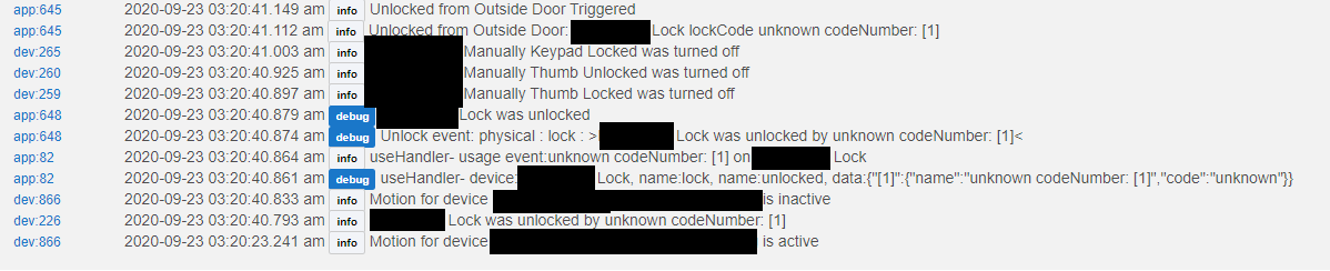

I get my normal events without problems and the lock/unlock commands seem to work.

Thing is, the name IS in the list--it is just at the end instead of the front.
Since the mapping of the codes<>names is NOT done by the lock itself, that means it's either in the driver or the Lock Code Manager.
If the checking routine is only going to look for "code 1" in slot 1 of the array--then the routine building that array should keep it "sorted" in order.

@mike.maxwell So, when the name IS present in the "lockCodes" array for the lock, what is reading the code number and deciding if there's a name or not?
In my case, the code is absolutely IN that array--it's just that "code 1" is NOT in the first position of that array (code "2" is in the first position). Something is apparently expecting the entries in that "lockCode" array to be in "numerical order by slot".
I'm not following this, please pm me a screen shot of the lockCodes (with encryption disabled) as shown on the device page for this lock.
the ordinal position of the codes is irrelevant, it's treated as a map so the order doesn't matter.
