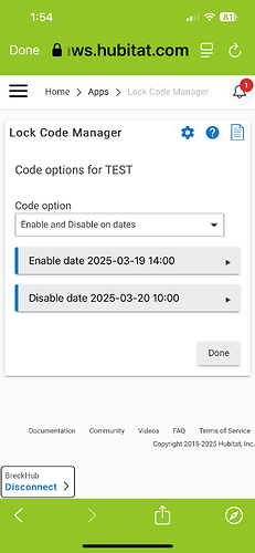

It's a C-8 Pro hub on F/W 2.4.0.151. And yes, instead of enabling the code at the schedule start time, it deletes it entirely. The debug log is on for the door lock, but there are no logs at all either when creating the entry in lock code manager, or when it deletes the user code at the scheduled enable time. I'll post an image from my phone of a test code I set up.

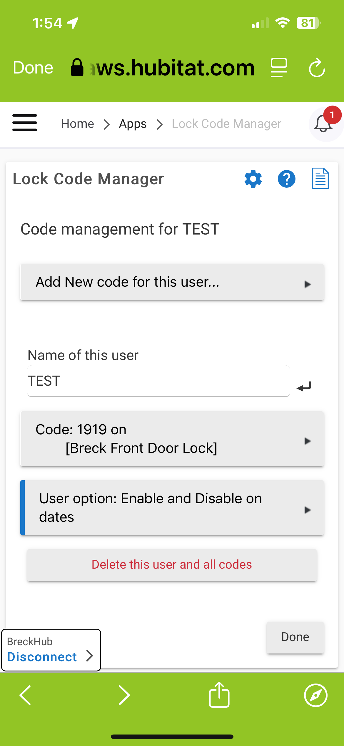

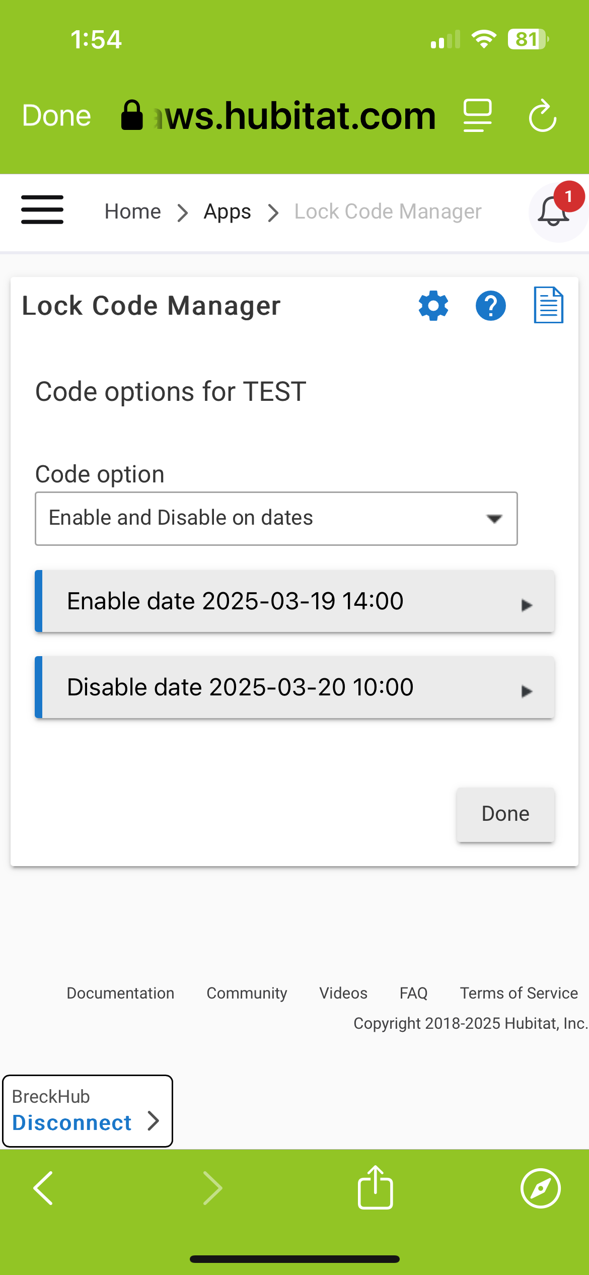

Here's a test code I just created with a start time in about five minutes from now.
And right on the hour at the scheduled time to enable the code, the app deleted the user code in its entirety, with nothing shown in the log.

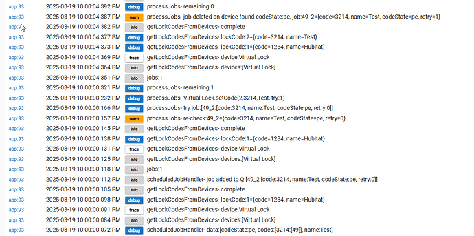

Very odd. For me lock manager does not delete any accounts. It only disables them based on the time.
Did you turn on Verbose logging in the app options? Cause it logs tons of stuff for me.

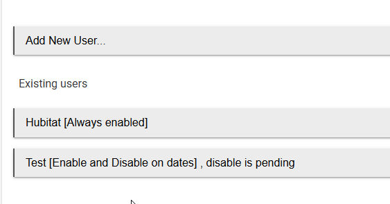

Waiting for the top of the hour to see what happens to my scheduled lock code.

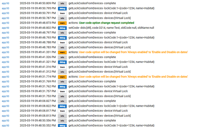

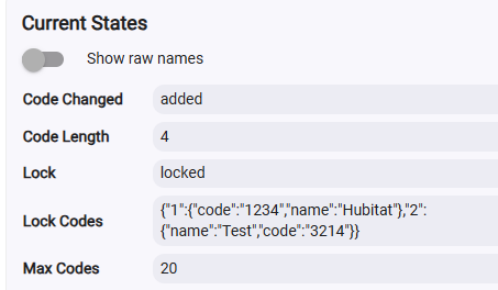

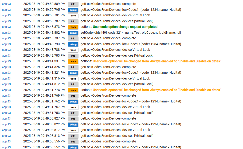

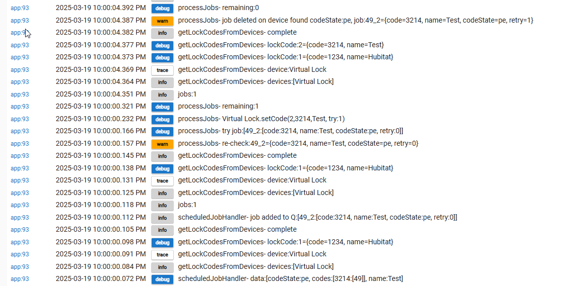

Worked fine for me.
(App Info)
LCM logging level is set in the App's options.
Note that it took me a little bit to get LCM to work like it should as I was not paying close enough attention the UI. I needed to hit the save icon after filling out a field. If not hitting done just drops what ever I did. Other apps like drivers work a little differently. If save is omitted done needs to be selected twice but the input is retained.
