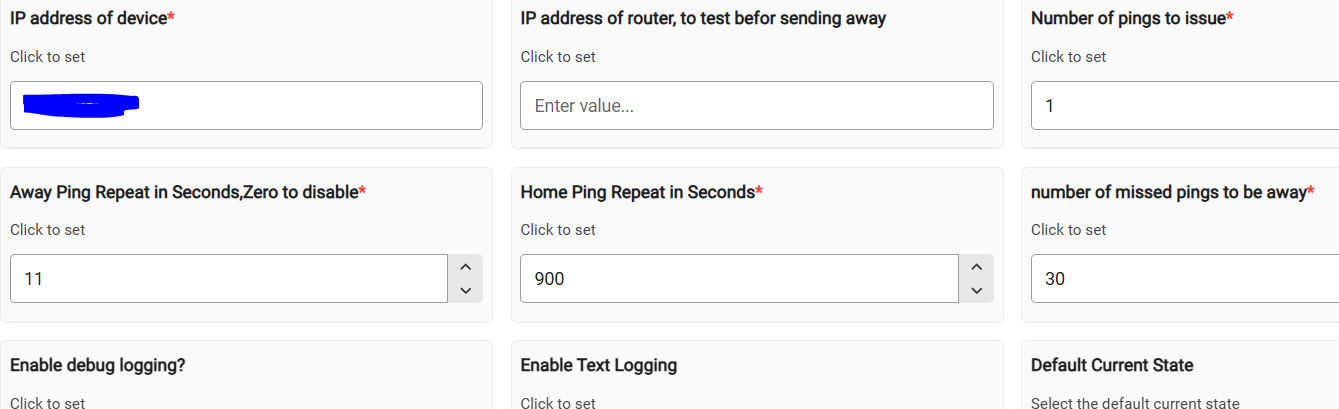

There is this Driver DriverWiFiPingPresence which pings for your mobile on the wifi network. Only thing you will have to do is reserve your IP address on the router for you phone(s) so they always connect using the same IP address.
The Kids phones don't have the Hubitat App on so this is was i use for them.

I've tried this driver in the past, but it didn't seem totally dependable for me, but it may have just been my phone or something. It was working though, generally.
