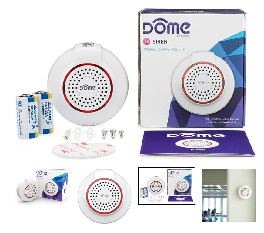

4 It's always a crap shoot what you'll get when ordering from AE so :crossed_fingers: The DMS01 Dome Ring Siren was my preferred device, even if it is Z-wave, but seems to be gone atm. :person_shrugging:

Dome Siren pic

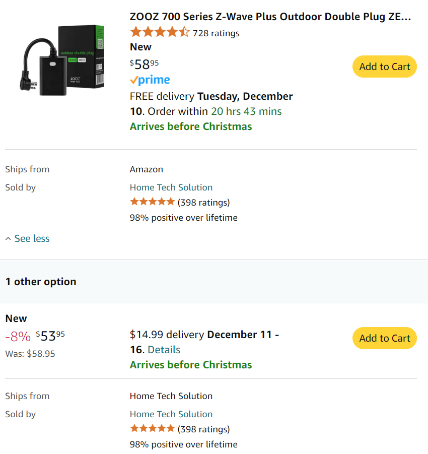

Unfortunately Zooz/Smartest House doesn't ship to Canada. :roll_eyes:
Wow - just saw that Smartest House does not ship there.
This is their Canadian "partner" for Zooz products: Plugs – Home Tech Solution
Not sure I'd call them partners :thinking:, they do own the distribution rights for Zooz products in Canada.
Because of that deal we pay a teensy bit extra for all Zooz products.
Not $24 plus exchange

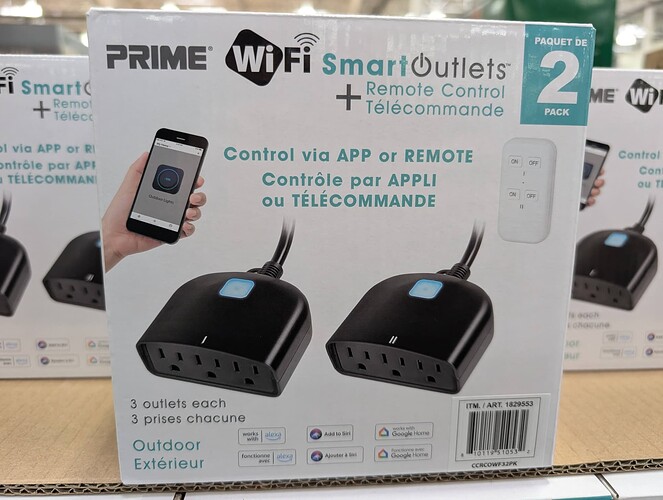

@Ranchitat
Instead of Kasa Smart Outdoor Smart Plug by TP-Link (KP400) - Smart WiFi Outlet with 2 Sockets, IP64 Waterproof, Works with Alexa and Google Home, 2.4GHz WiFi Required, No Hub Required, Sunset & Sunrise Offset Black : Amazon.ca: Tools & Home Improvement
What about this?
That won't be able to be integrated into Hubitat, but if you just need an outdoor wifi outlet, it's probably fine.
The Kasa is natively supported by HE, the Prime might be controllable using a community integration but it will likely be cloud dependent.
Or it might be flashable with Tasmota... :thinking:
I think @Sebastien did something with some Costco Prime stuff.
Edit: But for that price I'd probably buy one to play with. :smiley:
Costco use to sell Globe wall warts that could be flashed with Tasmota. I have a lot of those, but most of them are on a shelf in the basement at this time. I wanted to use them to track power usage, but ended-up getting an Emporia Vue, so no longer needed them for this. I do have a few in use however to turn on/off some devices.
