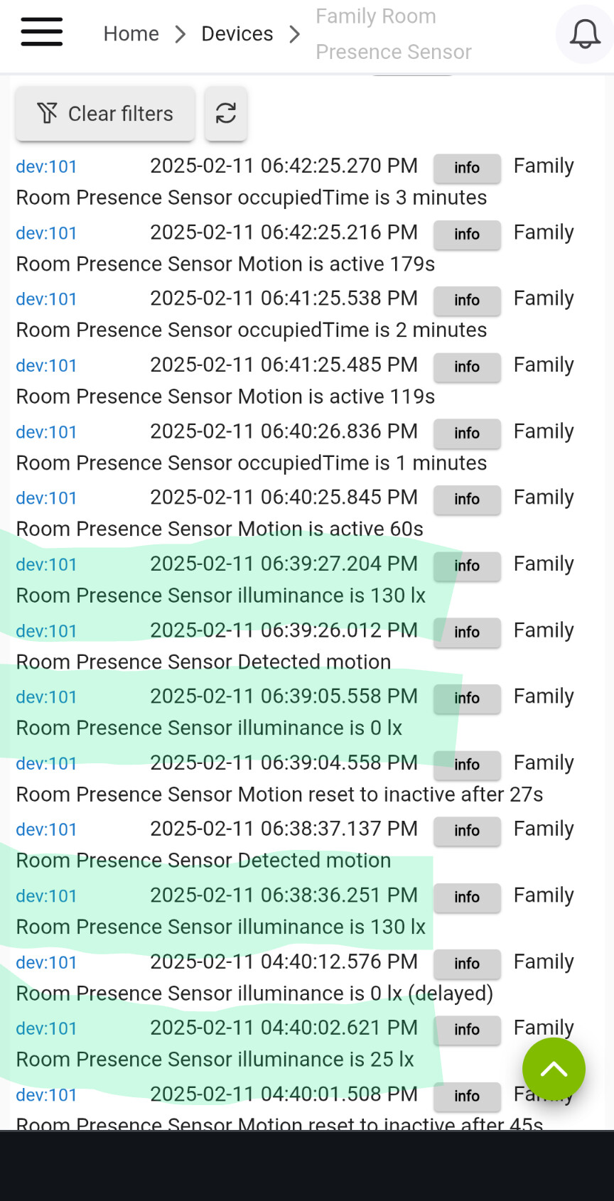

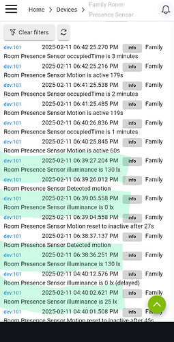

That is a possibility. It is strange that my 3 works correctly and yours do not. It is almost like a setting or something in the sensor itself. I attached the log of my family room. You can see someone was in there this evening, light came on, lux went up, light off, lux to zero. Then when I got home I cycled it a couple times in and out. Yes it is really dark in there so when the lights go out zero lux is expected.

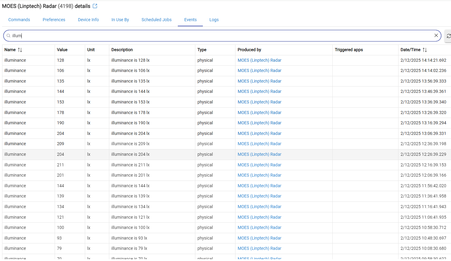

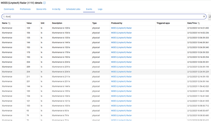

Hi guys,
My device (white label 'MOES', TS0225 _TZ3218_awarhusb Tuya Version
1.0.6) seems to be sending the illuminance reports as expected:
I am swamped these days, but hopefully, I will have the chance to research the possible reason(s) that illuminance reporting is not working in other environments.
