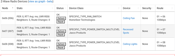

that's not the z-wave details page... In your web browser you want to go to yourhubip>>settings>>z-wave details

Sorry - I thought you wanted device info from my HomeSeer system.
