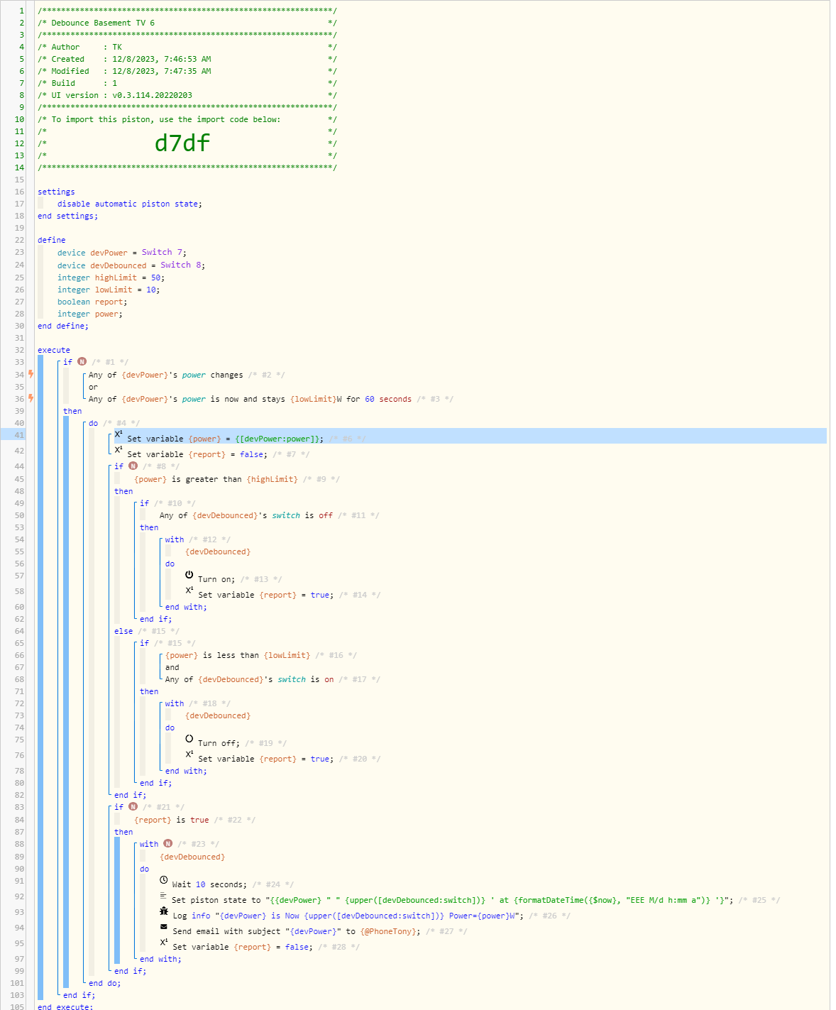

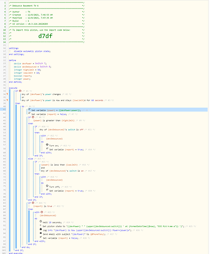

Another question about emails. I use Send Email to send a text message to my cell phone using the Verizon email address that gets received as a text. While that works, I'm finding that there can be a significant time difference between the time it is send, or at least when the command is sent, and when the text is received, on the order of 1 hour. I realize there are many players involved in making this work, but is there any reason why sending an email via a piston could be delayed in Hubitat or WebCore? Is there any way to determine the time that Hubitat sent the command to the cloud?

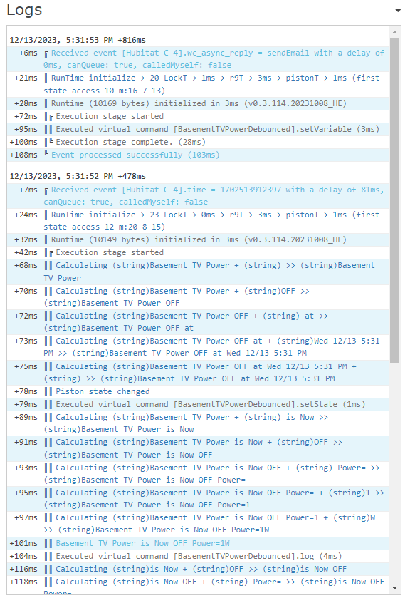

piston logging full or medium should show you when it was sent to the webcore servers.

This shows the problem, but in this case, the time it was received by my cell phone was 5:42pm, which looks to be a 10 min difference.
So the piston execution looks clean.
The remaining two places to be checked are the webcore server, and then if your phone provider is delaying things.

The email action hits the webCoRE API immediately and then the server dispatches it to Mailgun for delivery. I do not have access to the Mailgun account so I can't tell whether it is responsible for further delays or rate limiting.
In my experience, while Mailgun may occasionally be delayed it is generally fast to deliver. I suspect that the delay may be coming from Verizon. Fortunately that can be tested by sending emails to the vtext address from your own email provider to see if similar delays affect those ad-hoc messages as well.
