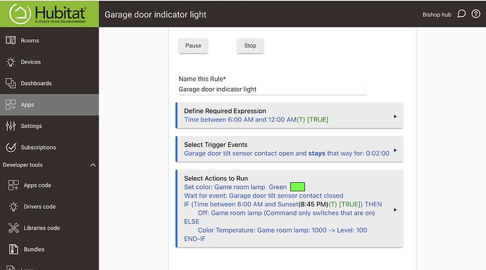

Can someone please help or guide me through a rule? I want to turn a smart bulb green when my garage door tilt sensor is open and then soft white when it’s closed. But only soft white when the bulb comes on at sunset. And then the bulb off at midnight. In other words I want to see this lamp green when my garage door is open. But soft white when it’s commanded on at sunset. Unless the garage is open. Then it’ll change accordingly

Not quite , layman’s terms I want this lamp to turn on at sunset and off at midnight. But also notify me if my door is up. Therefore bulb is green if door is up, but reverts to soft white if door is down
I forgot to mention I want the green light to work all day. But the whole thing shut down at midnight. If that makes sense

Ok green light to indicate door open after two minutes From 6 am till midnight. Green light to turn off when door closed. But soft white to turn on at sunset till midnight unless door is open then it remains green. But able to revert to soft white when door is closed from sunset till midnight

Mostly number 2. I don’t want the light to illuminate if I open my garage to go to work. Hence the two minute delay. But I want to see green if my door is open from 6 am till midnight. But I also want the lamp to be soft white if I’m home with door shut. Or green if door open. Then just nothing after midnight.
No illumination if door is closed between midnight and sunset the next day

Ok I tried. Does this look good?
Looks good, except two things. When you set the color to be green, you should also set the level (for eg. Level: 100 or Level: 50).
Second, a color temperature of 1000 probably cannot be reached by your RGBW light, and would be very very RED in color. Soft white is anywhere from a CT of 2700-3300, which is why I chose 3000.
Ok I did those row little modifications. But my light indicates the door is shut automatically at sunset.
